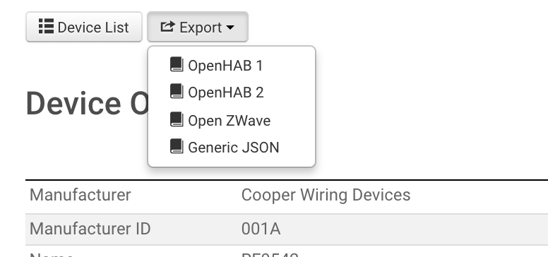

That’s it… If there are options in the parameter configuration, the database will create a channel with these options when the database is exported. You can see this if you go and click on the export button at the top of the page -:
When you’re done, click the request approval button and I’ll take a look. I try and do an export into the binding once or twice a week…
