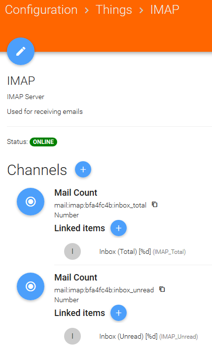

I’m trying to configure E-Mail things (https://www.openhab.org/addons/bindings/mail/) and I’ve added SMTP and IMAP items.
After that, everything I see on the web pages refers to things like “mail.things” and “mail.items” and I can’t find anything like that on the Paper UI or on the server.
All of the configuration changes I have made are in “/var/lib/openhab2/jsondb” and there is nothing remotely near to what the bindings page has.

It may be self explanatory to people that have been using this for a while, but the UI doesn’t have the kind of input fields like
“Number InboxTotal “INBOX [%d]” { channel=“mail:imap:sampleimap:inbox_total” }”
I have set the label to “InboxTotal”, the Type to “Number” and the Dimension is “DataAmount” but how am I supposed to define the string or the channel?
I am at a total loss.
