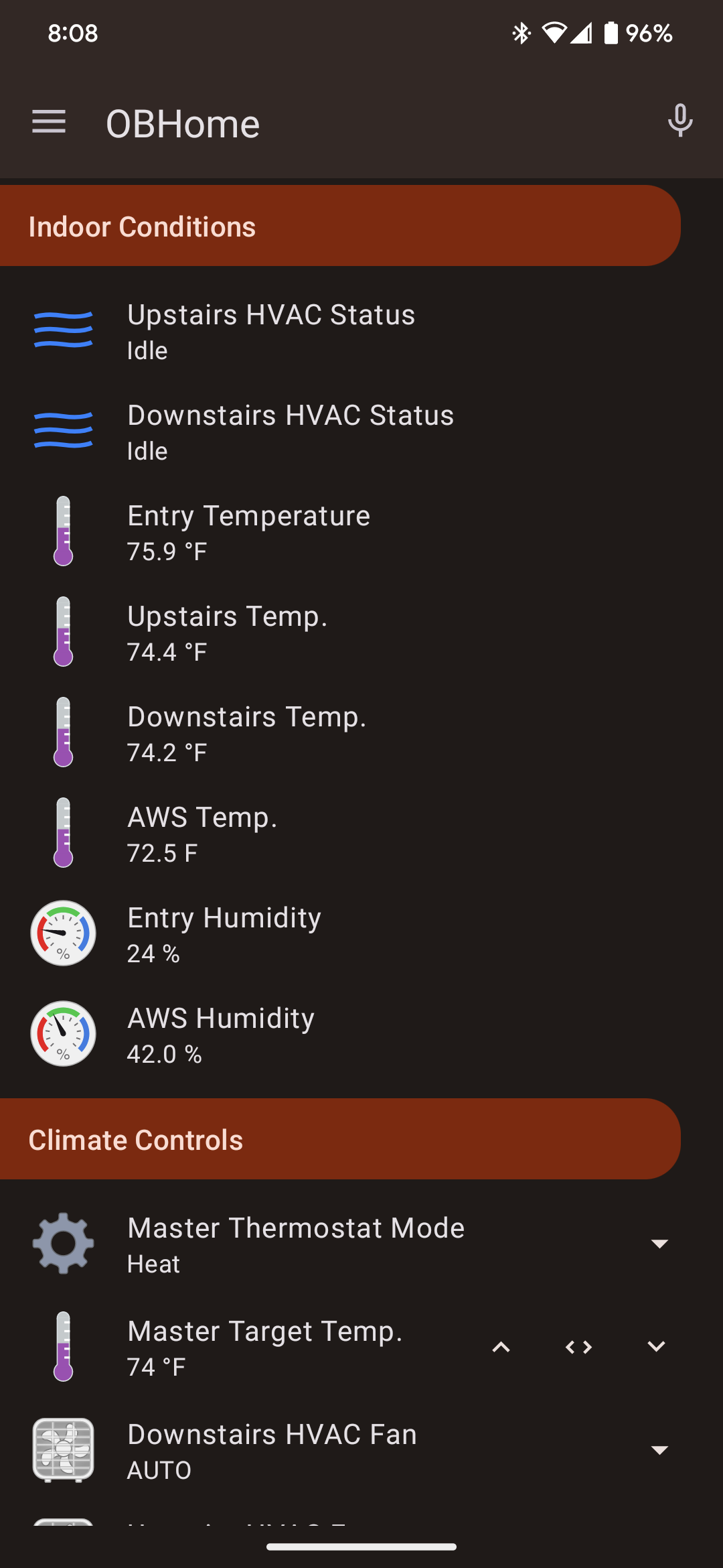

I mainly like the new look, and it’s awesome to see the dev activity. I think that values should be moved back over to the right side though
It’s always possible to pin any web page as an app on either iOS or Android. Open the URL in the browser and in the menu somewhere there will be an option to “Add to the homescreen” or something like that and you’ll get the browser based BasicUI as an “app”. But you need the Android app to get notifications and some of the other more advanced features.
Right, and with the value to the right, it would be (and previously was) even more truncated.
In the case of the setpoint I was thinking already whether the middle button is needed at all (touching the row outside of the buttons does the same thing), but there are other cases (rollershutter, color chooser) where 3 buttons are definitely needed.

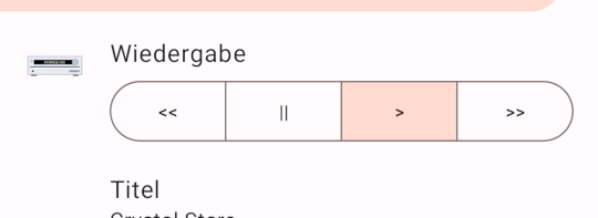

But maybe we could get away without the option by applying some heuristics? Let me illustrate by a pet peeve of mine, the widget for Player items, which are rendered as buttons:
It’s ugly not (just) because of the needed amount of space, but also due to the ASCII button texts and the useless 4th button (play and pause can’t be active at the same time anyway).

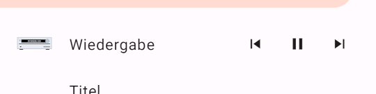

Therefore I’m working on a patch that collapses them into a layout similar to roller shutters:
For implementing it, I look at the properties of the switch widget, so basically employ heuristics to recognize this case. I wonder whether the same thing would work for your use case as well, checking e.g. for button count <= some limit && labels of all mappings have only 1 character and if that’s the case, display in one line. The interesting part then becomes how to display the unicode glyphs as images…

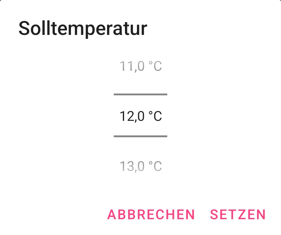

Number item, rendered as setpoint on the sitemap:
Setpoint item=Tuya1Bad_Setpoint minValue=5 maxValue=30 step=1
old behaviour:
there was a “set” button on the setpoint widget which you needed to press to send the changed value
events.log for old behaviour
2023-01-28 19:57:57.726 [INFO ] [openhab.event.ItemCommandEvent      ] - Item 'Tuya1Bad_Setpoint' received command 12.0
2023-01-28 19:57:57.728 [INFO ] [penhab.event.ItemStatePredictedEvent] - Item 'Tuya1Bad_Setpoint' predicted to become 12.0
2023-01-28 19:57:57.731 [INFO ] [openhab.event.ItemStateChangedEvent ] - Item 'Tuya1Bad_Setpoint' changed from 8 to 12.0
new behaviour:
there is no “set” button anymore and if you change the temperature, every single changed value gets send to the device:
events.log for new behaviour:
2023-01-28 19:58:40.966 [INFO ] [openhab.event.ItemCommandEvent      ] - Item 'Tuya1Bad_Setpoint' received command 13.0
2023-01-28 19:58:40.967 [INFO ] [penhab.event.ItemStatePredictedEvent] - Item 'Tuya1Bad_Setpoint' predicted to become 13.0
2023-01-28 19:58:40.969 [INFO ] [openhab.event.ItemStateChangedEvent ] - Item 'Tuya1Bad_Setpoint' changed from 12 to 13.0
2023-01-28 19:58:41.238 [INFO ] [openhab.event.ItemCommandEvent      ] - Item 'Tuya1Bad_Setpoint' received command 14.0
2023-01-28 19:58:41.238 [INFO ] [penhab.event.ItemStatePredictedEvent] - Item 'Tuya1Bad_Setpoint' predicted to become 14.0
2023-01-28 19:58:41.241 [INFO ] [openhab.event.ItemStateChangedEvent ] - Item 'Tuya1Bad_Setpoint' changed from 13.0 to 14.0
2023-01-28 19:58:41.760 [INFO ] [openhab.event.ItemStateChangedEvent ] - Item 'Tuya1Bad_Setpoint' changed from 14.0 to 13
2023-01-28 19:58:42.441 [INFO ] [openhab.event.ItemStateChangedEvent ] - Item 'Tuya1Bad_Setpoint' changed from 13 to 14
2023-01-28 19:58:42.592 [INFO ] [openhab.event.ItemCommandEvent      ] - Item 'Tuya1Bad_Setpoint' received command 15.0
2023-01-28 19:58:42.593 [INFO ] [penhab.event.ItemStatePredictedEvent] - Item 'Tuya1Bad_Setpoint' predicted to become 15.0
2023-01-28 19:58:42.594 [INFO ] [openhab.event.ItemStateChangedEvent ] - Item 'Tuya1Bad_Setpoint' changed from 14 to 15.0
2023-01-28 19:58:42.647 [INFO ] [openhab.event.ItemStateChangedEvent ] - Item 'Tuya1Bad_Setpoint' changed from 15.0 to 14
2023-01-28 19:58:42.673 [INFO ] [openhab.event.ItemCommandEvent      ] - Item 'Tuya1Bad_Setpoint' received command 16.0
2023-01-28 19:58:42.674 [INFO ] [penhab.event.ItemStatePredictedEvent] - Item 'Tuya1Bad_Setpoint' predicted to become 16.0
2023-01-28 19:58:42.675 [INFO ] [openhab.event.ItemStateChangedEvent ] - Item 'Tuya1Bad_Setpoint' changed from 14 to 16.0
2023-01-28 19:58:43.041 [INFO ] [openhab.event.ItemCommandEvent      ] - Item 'Tuya1Bad_Setpoint' received command 17.0
2023-01-28 19:58:43.042 [INFO ] [penhab.event.ItemStatePredictedEvent] - Item 'Tuya1Bad_Setpoint' predicted to become 17.0
2023-01-28 19:58:43.043 [INFO ] [openhab.event.ItemStateChangedEvent ] - Item 'Tuya1Bad_Setpoint' changed from 16.0 to 17.0
In both cases shown, the difference between old and new value is 4 degrees.

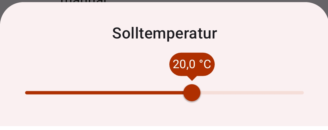

Aah, now I understand, thanks. I thought he’s talking about the ‘Slider’ widget, not the ‘Setpoint’ one. Yes, the slider bottom sheet should limit the number of sent values the same way as the Slider widget (only send if no change for at least 200ms). I’ll look into it.
Thx yes this is what I meant.
Maybe send command if ‘finger release slider’? :slightly_smiling_face:
