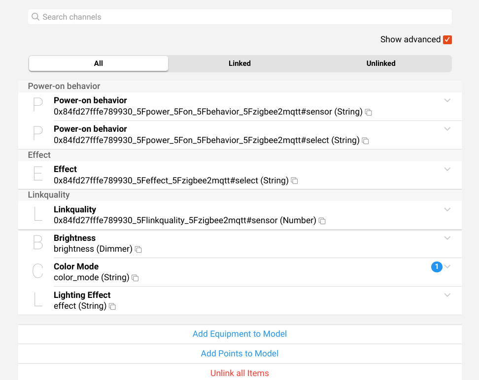

New MQTT setup. Not all channels are discovered
I’m trying to transition from deCONZ to Zigbee2MQTT.
I have successfully installed Z2MQTT on a Pi4 with a Sonoff dongle, and have paired some lights and plugs.
In Z2MQTT I can see all the available channels, on/off, colour temperature etc, but in OpenHAB, colour temperature, colour temperature startup, and on/off is missing when using the auto discover.
Any advice?

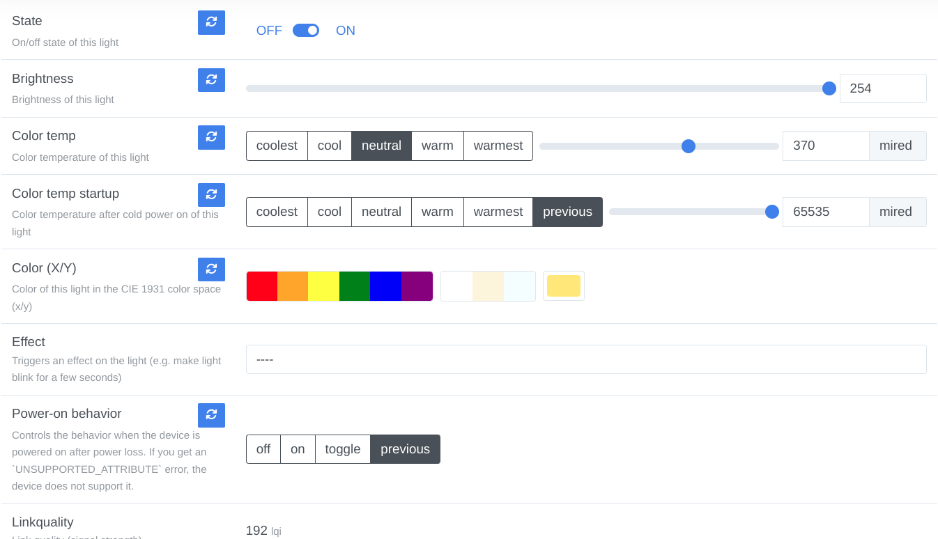

I have zigbee2mqtt and sonoff dongle.
I have never used the auto-discover.
I manually set up each device and find the information from the zigbee2mqtt web page.
Example: Philips 046677585235 control via MQTT | Zigbee2MQTT
I use friendly names and have the home assistant stuff turned off.

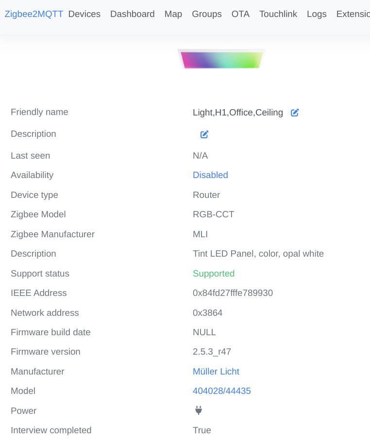

I’m trying to get mine working with this but it’s not happening for me:
Thing mqtt:topic:LightH1OfficeCeiling "Light,H1,Office,Ceiling" (mqtt:broker:aab6726def) {
    Channels:
    Type switch : onoff "On/Off" [ stateTopic="zigbee2mqtt/Light,H1,Office,Ceiling/state", commandTopic="zigbee2mqtt/Light,H1,Office,Ceiling/state/set" ]

On closer inspection, you’ve used commas in your topics.
Note that everyone else’s examples are using slashes.
Good observation. That will never work. :smiley:
