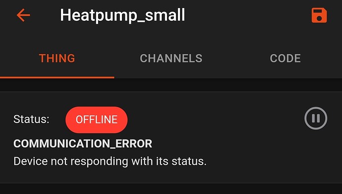

Somehow my configuration initializes ok and the Thing goes “Online” and I followed the steps how to add it
First of all it shows online but it does not show any temperature settings or actual temperatures.
If I try to turn the power on of the AC it only shows:
I am not sure where else to look, used the procedure of retreiving the key and token and also that worked…
Any further idea?

Somehow the binding seems to crash when I change a status for example on. Then I edit the Thing and save it and it comes back online.
This is the log:

> > 22:45:08.229 [TRACE] [dler.MideaACHandler$ConnectionManager] - Device mideaac:ac:Heatpump_small@192.168.2.90 response                                for handshake_request: 83700040200100004CED715A57DC4A49A3D625FBFCEDE5A76D9F9801D777DA486698D5CDE6640618F5F770F2FA68F9E                               D0D599940044282F194CEBB23A32AE1FF0157938772902129
> > ^C~                                                                                                                                                  openhab> 22:45:10.776 [TRACE] [dler.MideaACHandler$ConnectionManager] - Performing connection check for mideaac:ac:Hea                               tpump_Midea at IP 192.168.2.90
> > 22:45:10.778 [TRACE] [dler.MideaACHandler$ConnectionManager] - Checking status of connection for mideaac:ac:Heatpump_M                               idea at 192.168.2.90
> > 22:45:10.778 [DEBUG] [dler.MideaACHandler$ConnectionManager] - Connection check FAILED for mideaac:ac:Heatpump_Midea a                               t 192.168.2.90
Any further idea?

I maybe have found an issue:
00:02:31.201 [WARN ] [ng.mideaac.internal.security.Security] - AES decryption error: InvalidKeyException: Illegal key size
I am using the msmart-ng tool to retrieve the key and token and my AC is registered and connect to Smarthome Cloud (formerly MSmarthome)
To where did you register your AC @borazslo and did you use msmart-ng? is it working for you now?

Yeah but no initial values are shown, it goes online and right after 2 seconds later the information about AESdecription error comes up, but Thing stays online.
Very strange
I was so happy to be able to control my AC / Heat pump now through OH
really would appreciate some more help / ideas…

see here
2.242 [DEBUG] [deaac.internal.handler.MideaACHandler] - MideaACHandler config for mideaac:ac:Heatpump_small is org.openhab.binding.mideaac.internal.MideaACConfiguration@6de6de95
00:32:02.243 [DEBUG] [deaac.internal.handler.MideaACHandler] - Configuration valid for mideaac:ac:Heatpump_small
00:32:02.243 [DEBUG] [deaac.internal.handler.MideaACHandler] - IPAddress: 192.168.2.90
00:32:02.256 [DEBUG] [deaac.internal.handler.MideaACHandler] - IPPort: 6444
00:32:02.257 [DEBUG] [deaac.internal.handler.MideaACHandler] - ID: 146235046504914
00:32:02.258 [DEBUG] [deaac.internal.handler.MideaACHandler] - Version: 3
00:32:02.261 [TRACE] [dler.MideaACHandler$ConnectionManager] - Connecting to mideaac:ac:Heatpump_small at 192.168.2.90:6444
00:32:02.281 [INFO ] [dler.MideaACHandler$ConnectionManager] - Connected to mideaac:ac:Heatpump_small at 192.168.2.90
00:32:02.464 [DEBUG] [deaac.internal.handler.MideaACHandler] - Changing status of mideaac:ac:Heatpump_small from UNKNOWN(NONE) to ONLINE
00:32:02.465 [DEBUG] [dler.MideaACHandler$ConnectionManager] - Device mideaac:ac:Heatpump_small@192.168.2.90 require authentication, going to authenticate
00:32:02.466 [TRACE] [dler.MideaACHandler$ConnectionManager] - Version: 3
00:32:02.467 [TRACE] [dler.MideaACHandler$ConnectionManager] - Key: xxxxxxxfc41e4a7888985f2dc78d88b9e599b792959143058e6ae5f826df2b9b
00:32:02.472 [TRACE] [dler.MideaACHandler$ConnectionManager] - Token: xxxxxxx202329bf31ede7cfaede68f51ffba5d1c914abd7301069adc8d2b6dde31054dc8d236916fefda65c46af5e3ba4dde04071fb97e8706ae6b4daa52b349
00:32:02.473 [DEBUG] [dler.MideaACHandler$ConnectionManager] - Device mideaac:ac:Heatpump_small@192.168.2.90 authenticating
00:32:02.474 [TRACE] [ng.mideaac.internal.security.Security] - Size: 64
00:32:02.475 [TRACE] [ng.mideaac.internal.security.Security] - Header:      837000402000
00:32:02.476 [TRACE] [ng.mideaac.internal.security.Security] - Data:        00000F88B3E202329BF31EDE7CFAEDE68F51FFBA5D1C914ABD7301069ADC8D2B6DDE31054DC8D236916FEFDA65C46AF5E3BA4DDE04071FB97E8706AE6B4DAA52B349
00:32:02.476 [TRACE] [ng.mideaac.internal.security.Security] - Result:      83700040200000000F88B3E202329BF31EDE7CFAEDE68F51FFBA5D1C914ABD7301069ADC8D2B6DDE31054DC8D236916FEFDA65C46AF5E3BA4DDE04071FB97E8706AE6B4DAA52B349
00:32:02.477 [TRACE] [dler.MideaACHandler$ConnectionManager] - Device mideaac:ac:Heatpump_small@192.168.2.90 writing handshake_request: 83700040200000000F88B3E202329BF31EDE7CFAEDE68F51FFBA5D1C914ABD7301069ADC8D2B6DDE31054DC8D236916FEFDA65C46AF5E3BA4DDE04071FB97E8706AE6B4DAA52B349
00:32:02.483 [DEBUG] [dler.MideaACHandler$ConnectionManager] - Response received length: 72
00:32:02.489 [DEBUG] [dler.MideaACHandler$ConnectionManager] - Response bytes: 83700040200100003E233FF3328640E629B90ABD59039E10C5269AEF515954DA9CFB76DE70A5F6246A58A3600F3D3E46D23D487D86EE480E04548FB9FDDDD0544268525ACEAC6009
00:32:02.490 [TRACE] [dler.MideaACHandler$ConnectionManager] - Device mideaac:ac:Heatpump_small@192.168.2.90 response for handshake_request length: 72
00:32:02.495 [TRACE] [dler.MideaACHandler$ConnectionManager] - Device mideaac:ac:Heatpump_small@192.168.2.90 response for handshake_request: 83700040200100003E233FF3328640E629B90ABD59039E10C5269AEF515954DA9CFB76DE70A5F6246A58A3600F3D3E46D23D487D86EE480E04548FB9FDDDD0544268525ACEAC6009
00:32:02.496 [WARN ] [ng.mideaac.internal.security.Security] - AES decryption error: InvalidKeyException: Illegal key size
