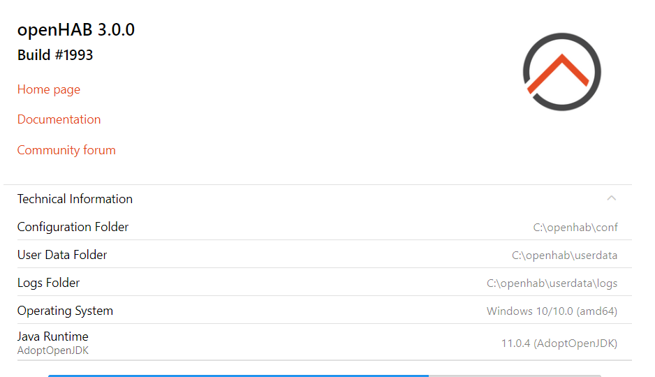

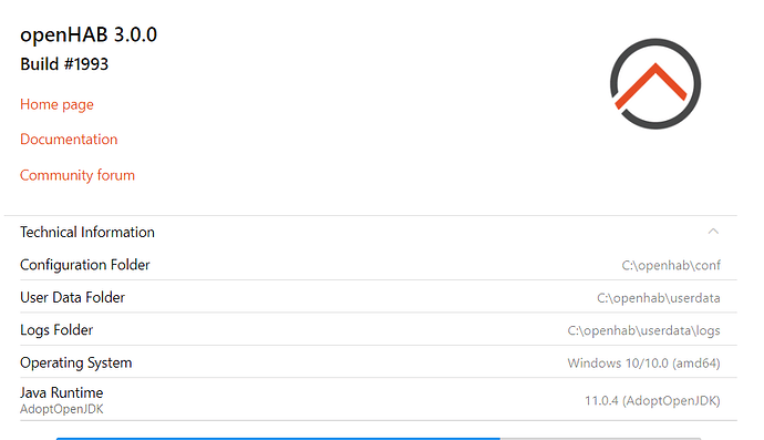

Sorry- To add
WIndows 10
Java 11
3.0.0-SNAPSHOT - Build #1993

I have installed build #1993 in my env and it works. I suspect that this has to do with the webthing configuration (webThingURI)
I have added a log into the updated snapshot link
