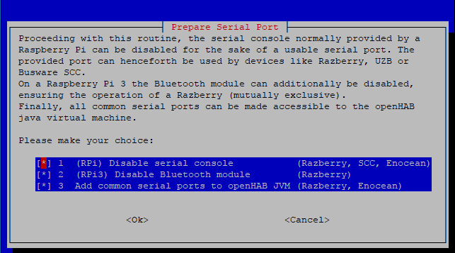

Serial Port Prepare serial ports for peripherals - [*] 1 (RPi) Disable serial console (Razberry, SCC, Enocean)
(RPi3) Disable Bluetooth module (Razberry) │
Add common serial ports to openHAB JVM (Razberry,
All done. After a reboot the serial console will be available via │
│ /dev/ttyAMA0 or /dev/ttyS0 (depends on your device).

If you have openhabianpi, please do not forget to add access to the /dev/tty* ports using the openhabian-config script.
When the script has started execute 30, 35 and select all options. Then and you should then all the way out and reboot.
Still no joy :frowning:
Hi Vic, Had the issue on a fresh install and did exactly as above, rebooted, deleted the controller, re-added with the correct ports (till now I only had /dev/ttyAMA0, after reboot now I had the correct /dev/ttyACM0 as well) and instantly the controller came alive. Hope it works for you.
