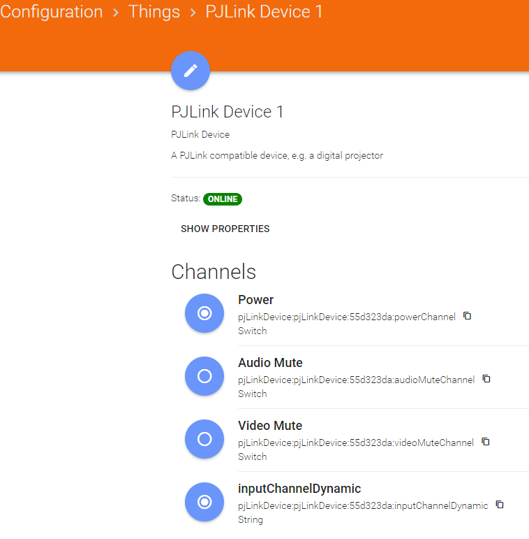

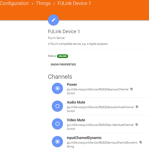

I have test the binding with a EPSON EB-4750W (PJ link Class 1) and EPSON EB-5530U (PJ link Class 2) it works.
I can Power off/on and change the Inputs.

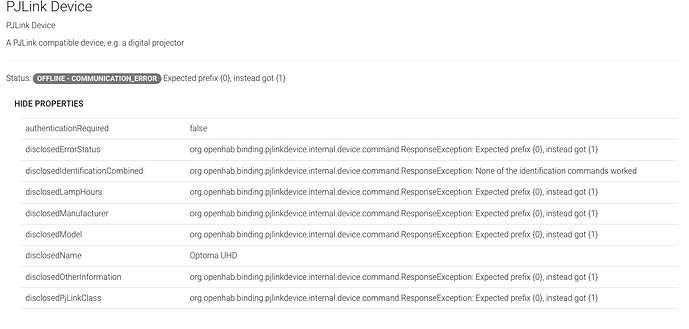

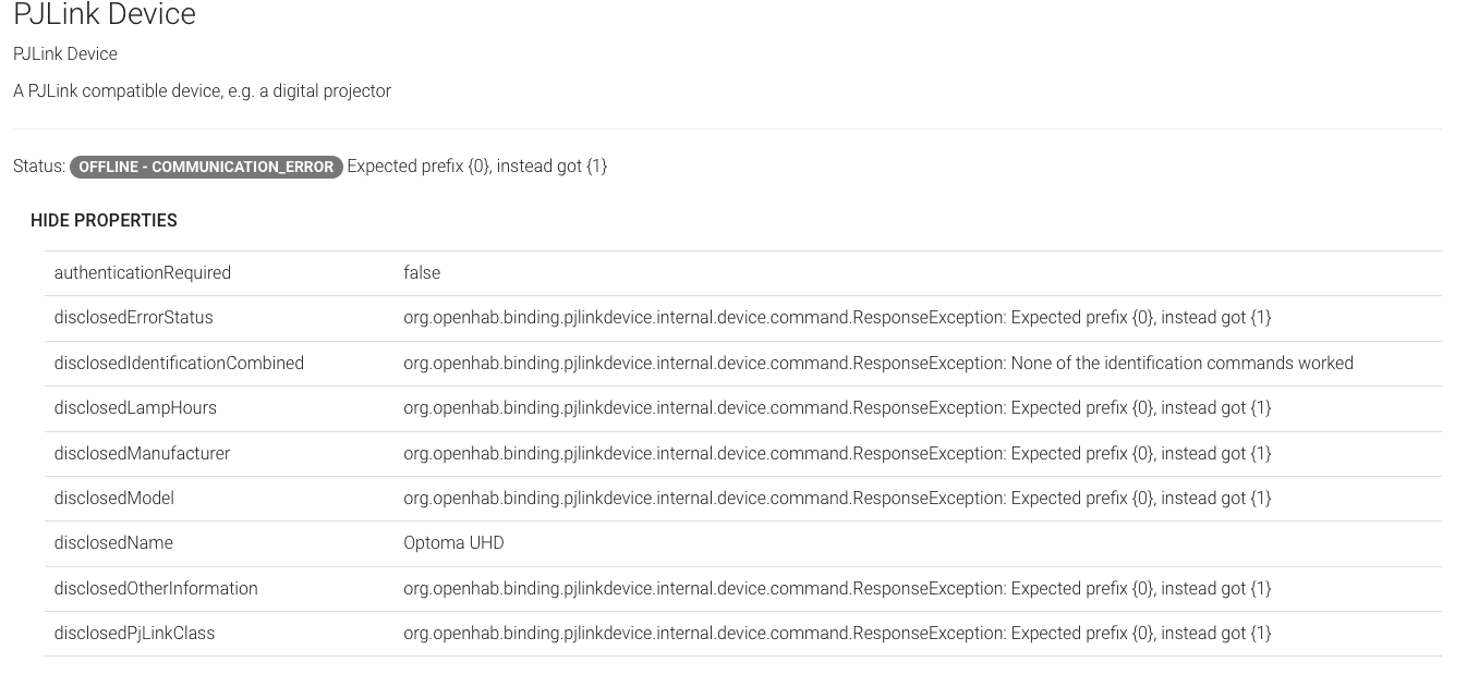

This still doesn’t work. It seems some info comes in (disclosedname)

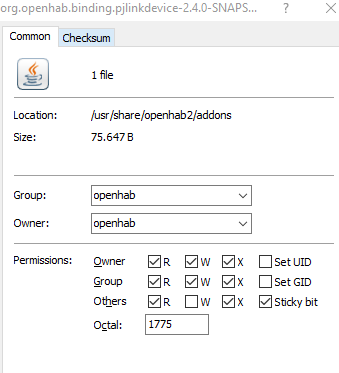

I checked and changed the rights temporarily to 777 but this doesn’t help.

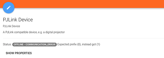

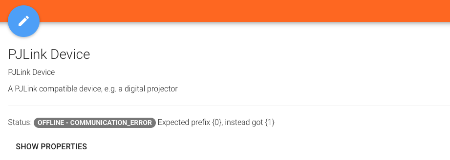

It seems like the optoma is sending some responses in a different format as in it doesn’t startsWith(fullPrefix)
Maybe you can build in some logging so I can check what responses actually come in? I already set the loglevel to debug for this binding.

thanks for testing the binding and analyzing the issue with the Optoma Projector.
I was thinking the same thing concerning the logging message, as you can see from the code it was intended to be more meaningful… I can’t fix that right now, but in the afternoon I will create a new version.
Maybe the Optoma responds with a class 2 response when we send class 1 commands or something like that.

Okay, this looks a bit like the binding is not patient enough to wait for the response from the projector.
I’ll have a look at the PJLink specs again to see whether that’s something that can be expected.
Regardless of the outcome of that, I’ll also provide a new version which is hopefully more robust in that regard soon.
further thinking about it, it rather seems that there are sometimes unexpected empty lines coming from the projector. The most recent JAR should now ignore empty lines and try to get another one.
