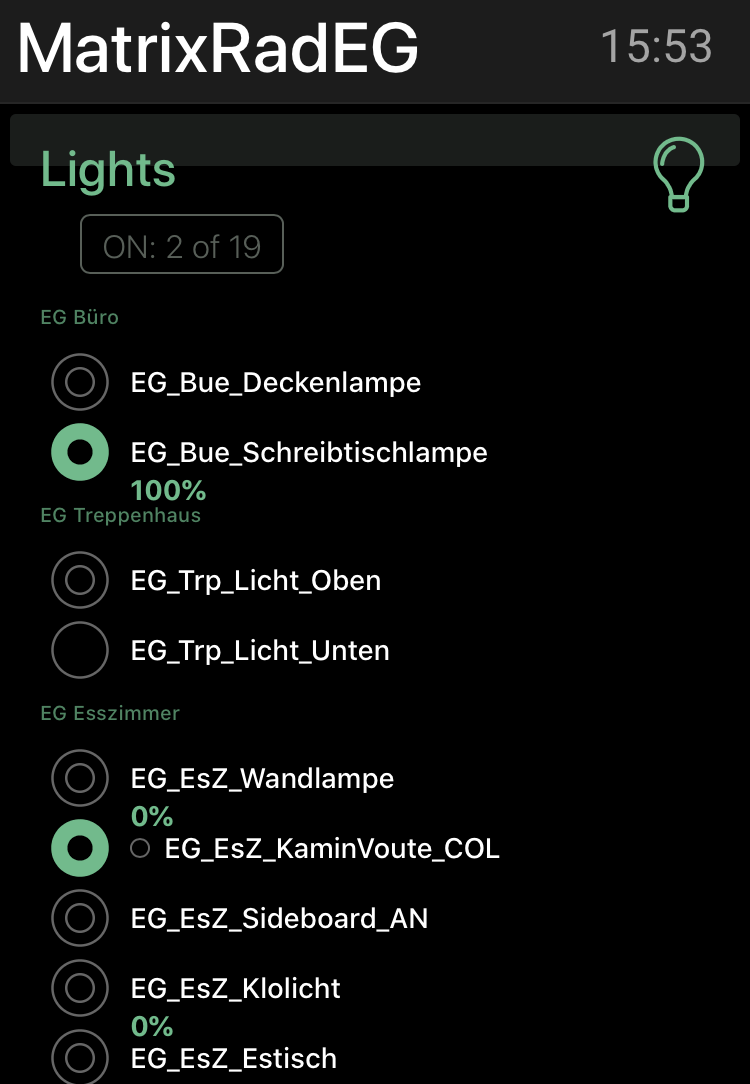

@eikowagenknecht Do you mean this?
Tablet:
It’s not finished yet. I’m not a developer. Just as scriptkiddie, using code of pmpkk. For now the widget loops through rooms given in first group. For each room it loops through the lights of this room given in the second group with all lights. I edited so that dimmer items are shown too. but up to now you can only switch them on or off.
Widget with Lights and Shutters in two Lists / Sections
You should scale widget full width an full length on Site / dashboard or more
Widget needs a group with all lights (switch, color, dimmer allowed) and a group with all rooms that should be shown
This widget is build from parts of the matrix-theme widgets

Not workin / in progressg: Hue (for me), room name / label switch, dimmer value formating, dimming.
Great work so far. I spent quite some time on this myself yesterday before I saw your answer. I got some things working: Switch, Dinmer (with slider), Color items. But I‘m missing others like the number of lights turned on. I‘ll have a look at your version and try to merge with mine and post the result here when it‘s done
@eikowagenknecht it would be very nice to see your results.
Additional info: I use the pride.css but the light count formatting i copied from matrix .css for element <div class= “summary“>
to have the nice box.
