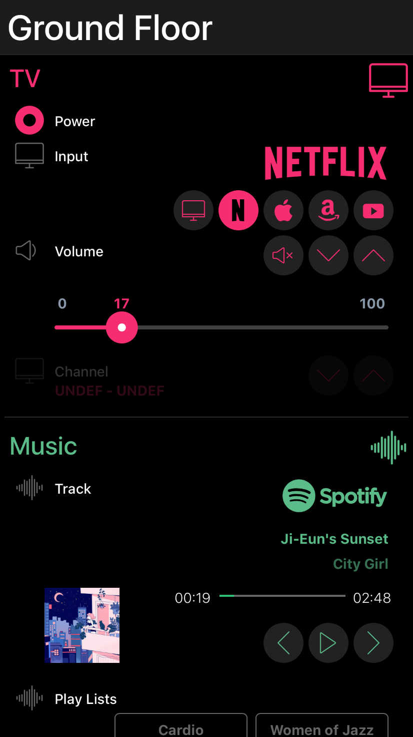

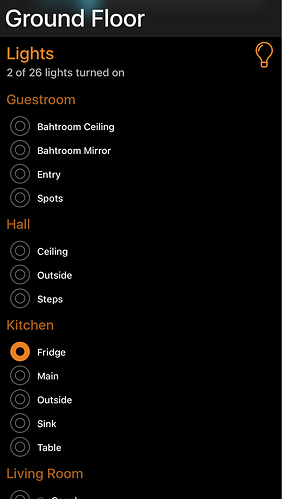

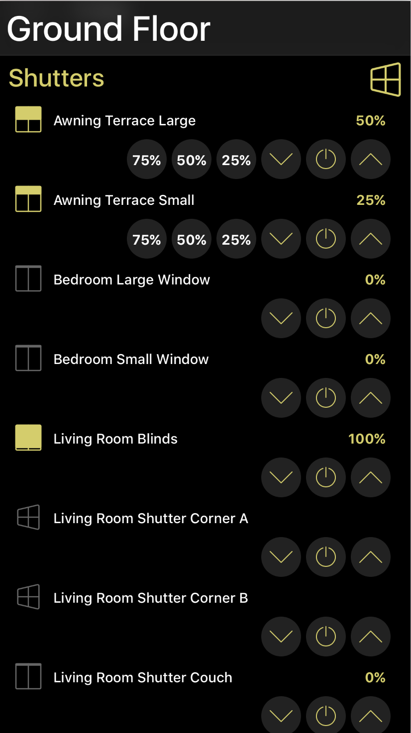

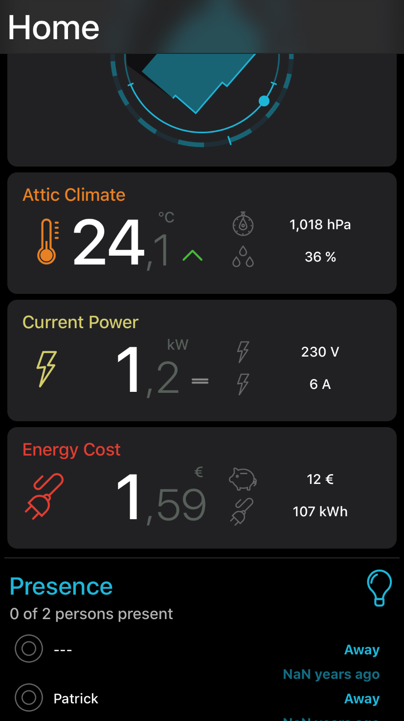

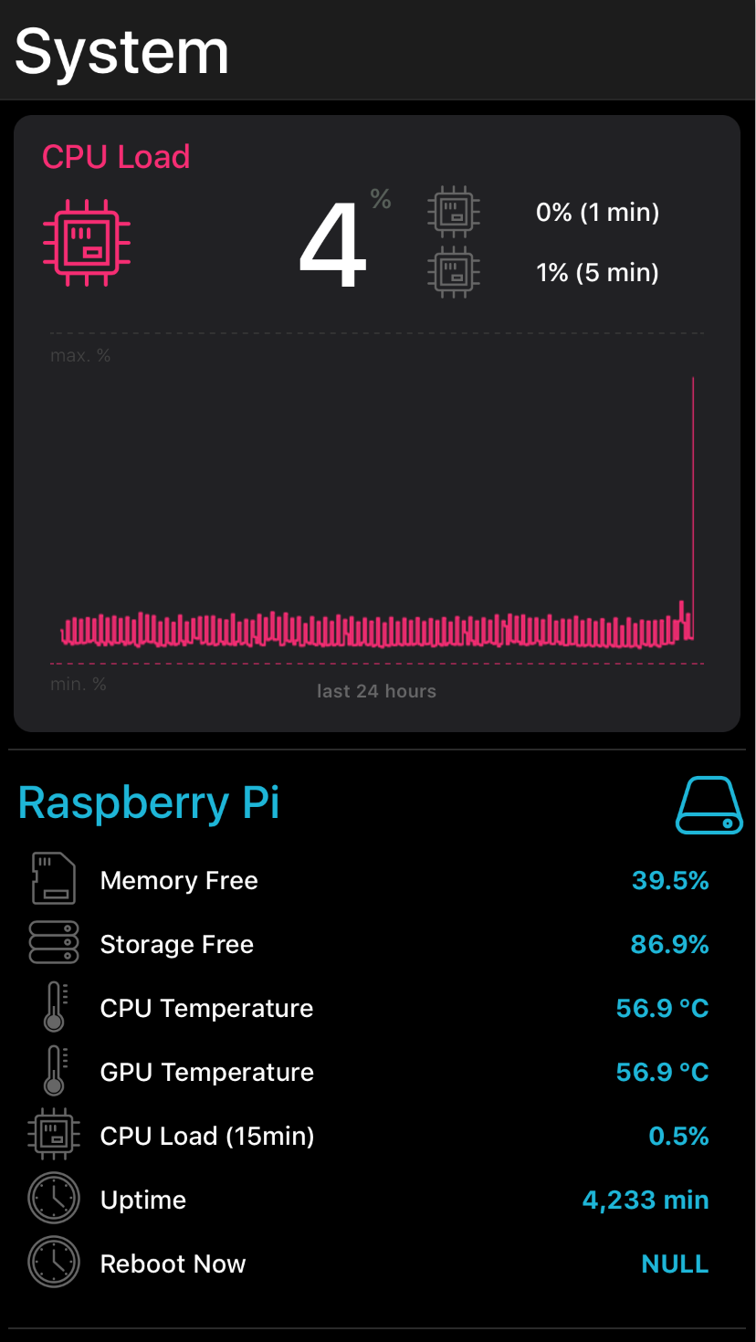

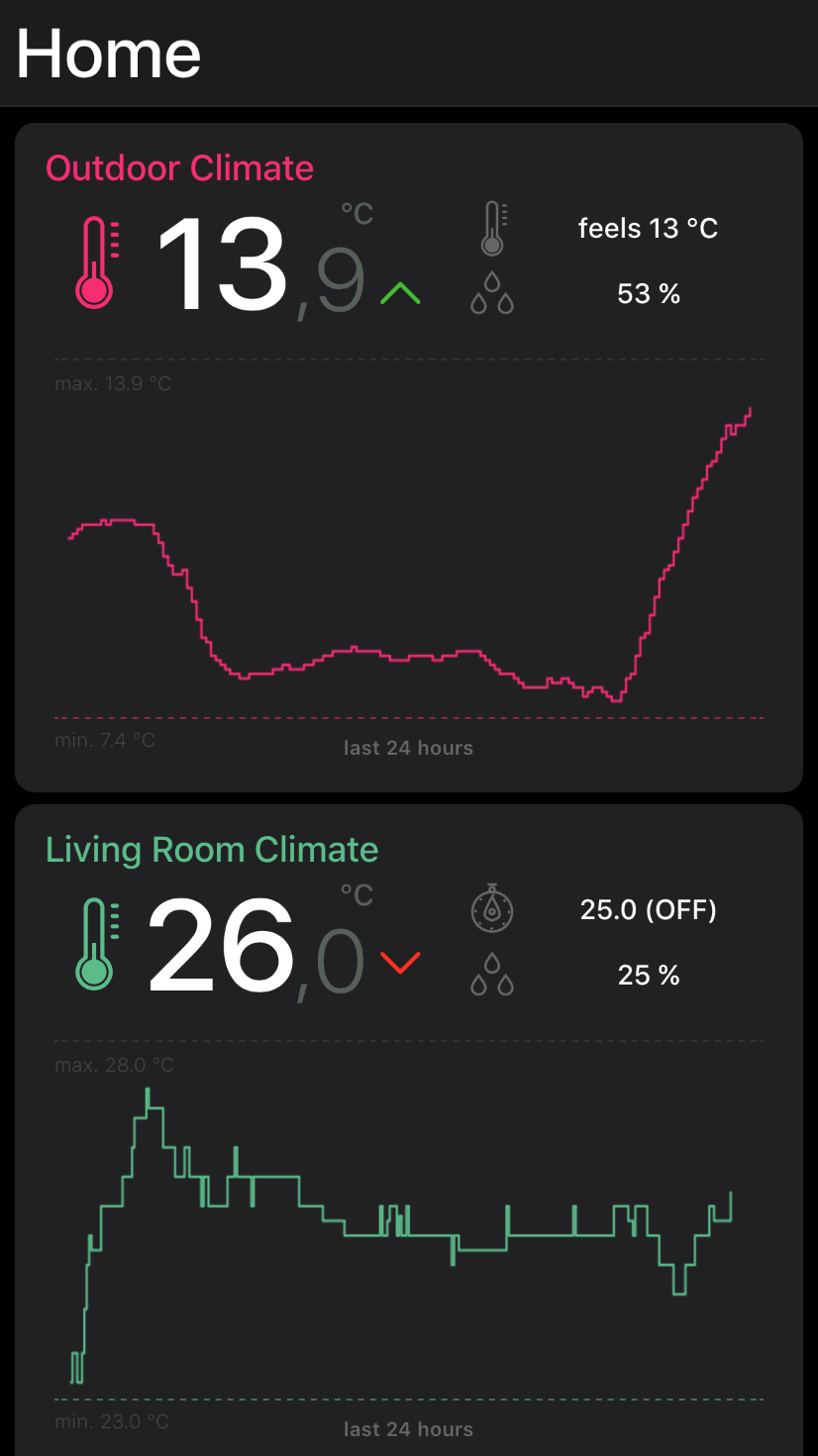

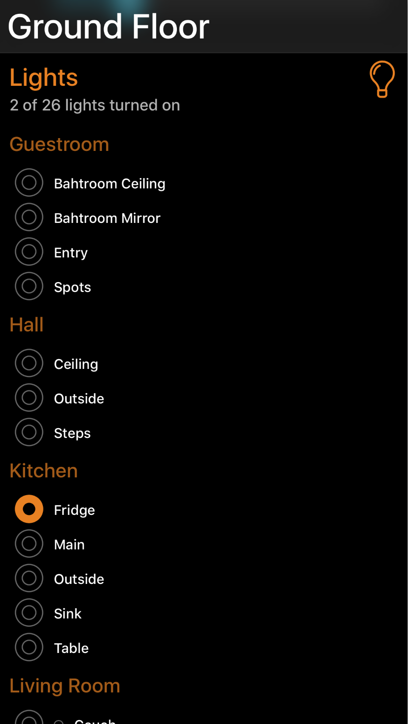

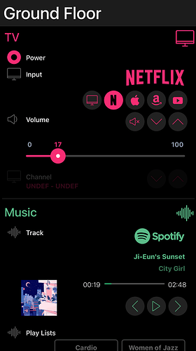

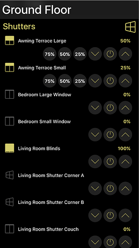

Some screenshots:
Looks good on tablets as well:

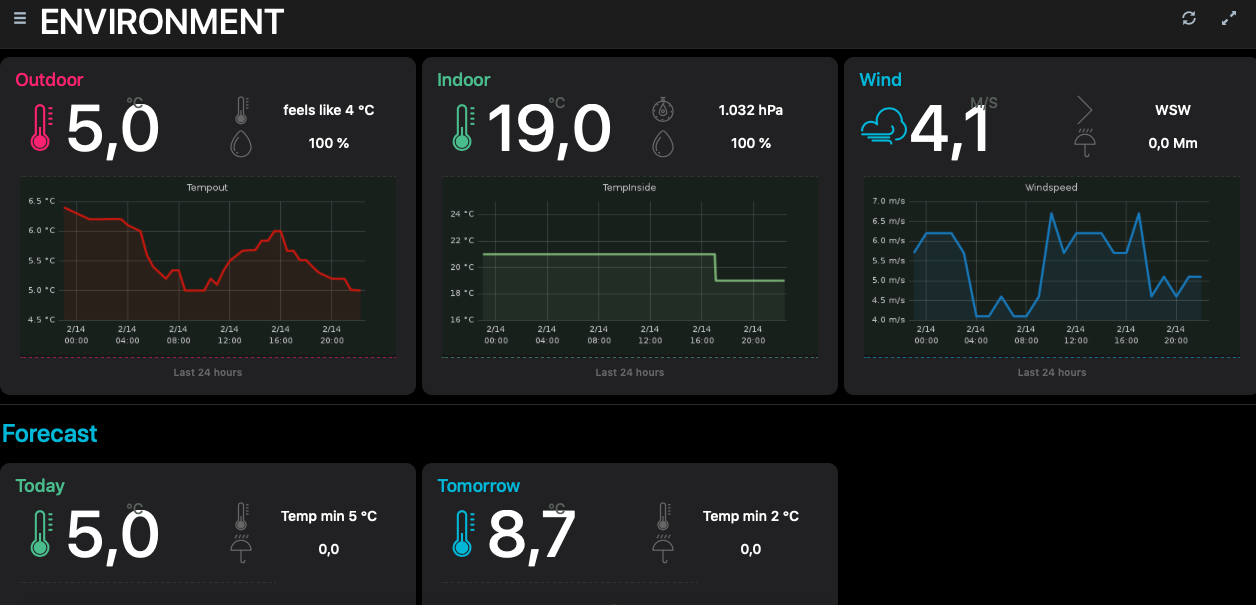

on my tablet and Macbook I have some issues with the “environment” (bigDash). The Celsius and m/s are placed on top of the value (see screenshot)? Any ideas as to what I am doing wrong?
<div oc-lazy-load="['/static/matrix-theme/jquery-3.2.1.min.js','/static/pride-theme/matrix.js']"></div>

First of all, it’s a wonderful further matrix-theme development!
Patrick, Thanks a lot for your work!
I solved your “The Celsius and m/s” problem like this - with the “main”, “decimal” and “sub” class:
