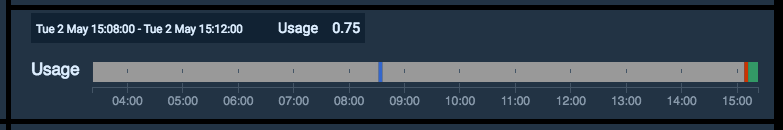

I am using this widget to display the current state of my HVAC system. I am storing the values with rrd4j so I am using integer values 0, 1, 2, and 3 to represent the different states.
Using numerical values, I see some odd behavior. Sometimes the timeline widget displays incorrect values / colors for points in the graph. Take a look at this screenshot, in which I am mousing over the small red sliver near the end of the graph. The displayed value is “0.75”, but that value was never sent to the item, and never shows up in the OH events.log. The item transitions directly from 0 (grey) to 3 (green) at this time.
2017-05-02 15:07:05.524 [ItemStateChangedEvent     ] - upstairs_thermostat_hvac_state changed from IDLE to FAN
2017-05-02 15:07:05.533 [ItemStateChangedEvent     ] - upstairs_thermostat_hvac_state_enum changed from 0 to 3
Perhaps this is a rounding or precision error or something? By the way, right now this seems to happen only for 12h or greater periods. If I use 4h or 8h periods then I don’t see this issue. Pushing it up to 1 week gives even weirder values.
That sounds like a normal rrd4j behaviou. What are your settings for the archives? You see that behaviour on values older then 12 houres. So you should have an archive which covers anything up to 12 houres and at least one for longer times. These other archives do calculate a single value for a time period, the calculation method is decided by the user (or the default).So, if the user decided to calculate those values for longer time steps out of the average of the smaller steps you will see such values. In other words, garbage in garbage out!
Interesting, I’m not that familiar with rrd4j so perhaps I was making some assumptions. So I’m understanding you correctly, this would only be a problem on data that is more than 12 hours old. In my screenshot above, I was examining data that had been recorded 10-15 minutes ago, so I’m not sure if this is the same issue. Also, as mentioned, this problem goes away when viewing the same data on a smaller graph timeline (4h vs 12h).
I’d like to be sure though. How do I check the settings for these archives, and/or set the calculation method for old values? I only need 24h of data, so is there a way configure rrd4j to keep all recorded values for 24 hours instead of 12?

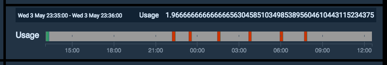

However, I still see the same behavior. Values for the exact minute where I make an update to the item are displayed in the timeline widget incorrectly. The values seem to be something between the previous state and the new state, e.g. if I move from 0->2 then the value is reported for one minute as “1.9966666…”.
Maybe I’m still making some incorrect assumption about the operation of rrd4j, but I’ve spent enough time on this, I’m just going to switch to mysql persistence instead and see if this still happens.
I guess this could be the issue, but you can see on the timeline widget which exact minute is highlighted.
For example, this is showing from 23:35-23:36:
But yes, it’s a possibility that the timeline widget itself is displaying these values improperly for some reason. I was trying to rule out problems with rrd4j by changing my config, but since I don’t know of a way to inspect the actual data in the database directly, I can’t say if it’s a timeline widget problem or a rrd4j problem.
