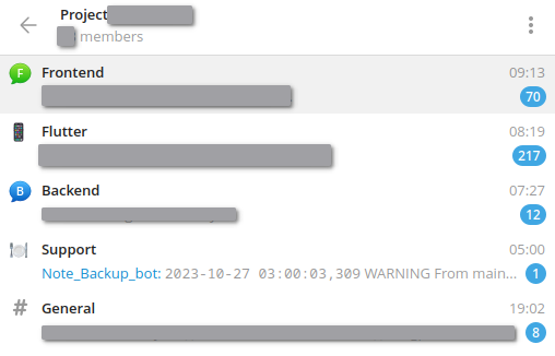

I guess some of you have allready noticed that you sometimes get automatically transformed to a “supergroup” (no way back) which will provide you with additional features (activating one of them starting the convertion also :wink:
The only usefull feature I guess for us is the ChatID+Topic stuff.
