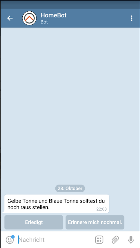

Example command for the action:
var String json_keyboard = '{"inline_keyboard":[[{"text":"Erledigt","callback_data":"trash_done"},{"text":"Erinnere mich nochmal.","callback_data":"trash_later"}]]}'
sendTelegram("BiergartenBot", "%s und %s solltest du noch raus stellen.", json_keyboard, gCal_Abfall_Event1_Summary.state.toString, gCal_Abfall_Event2_Summary.state.toString)
Creates this:
(Translation: Bring the trash out: [Done] [Remember me again])
It is easy to ingegrate e.g. item names into the JSON string

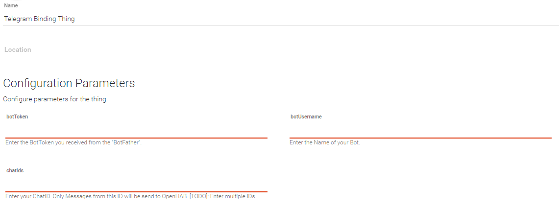

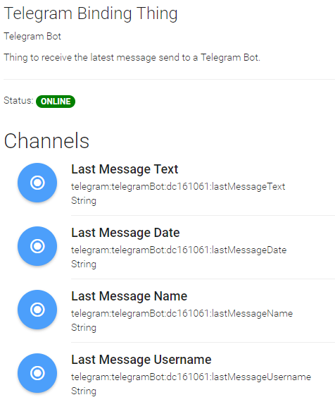

Configuration of the binding:
You have to put the name and the token of your bot and your ChatID into the Thing configuration. The binding only accepts messages from the give ChatID

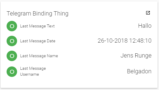

Seems to work pretty well, however I have some observations:
  • lastMessageDate maybe should return DateTime.
  • lastMessageUsername is not populated, it remains empty (NULL)

It is only populated if you have an username set in Telegram. Since its optional to have one it can be NULL. Could you check if you have a username set please? In the Telegram App you can set one under “Settings” in the Hamburger menu. The second row should be your username. (Android, iOS may vary)
