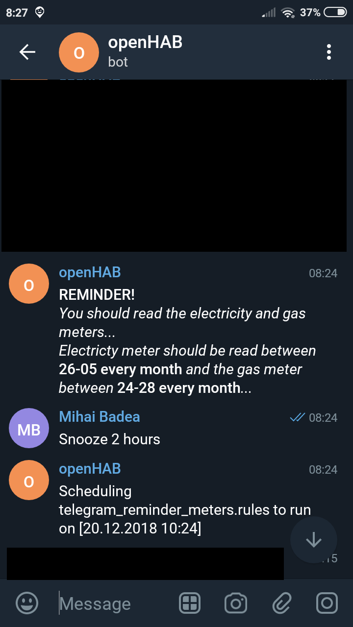

I wanted to send a Telegram reminder, for example to read the electricity and gas meters - this is simple enough - but I wanted to re-schedule the alert. Why? Well, some kind of snooze mechanism… I often forget to read the meters because, when I receive the reminder, I’m not at home…

    TelegramResponse_Reminder.postUpdate("telegram_reminder_meters")
As you can see, it is initially programmed to run on 18:00 every day between 26 and 28.12.2018.

Whenever the TelegramResponse changes the following rule with read the response and change telegram_reminder_meters.rule cron trigger:

                        case "Snooze 2 hours": {
                            new_cron = now.plusHours(2).toString("0 m H d M ? yyyy")

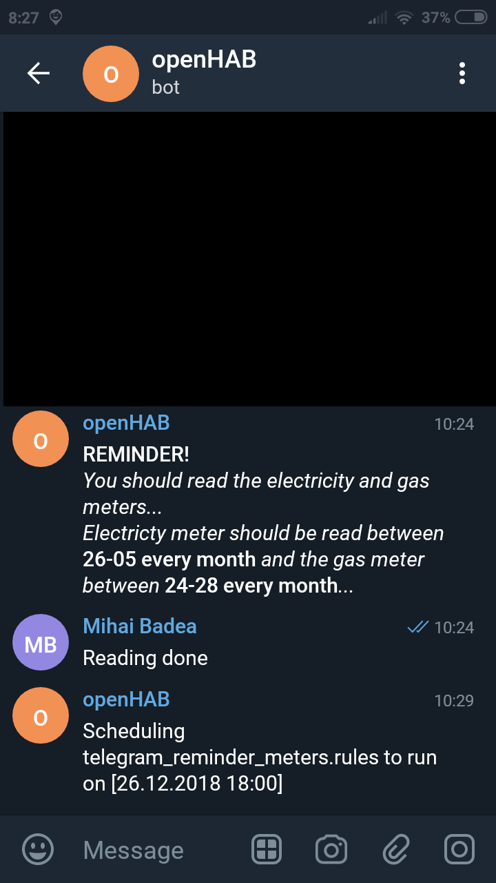

                        case "Reading done": {
                                new_cron = now.withDayOfMonth(26).withTime(18,0,0,0).toString("0 m H d-28 M ? yyyy")

                        sendTelegram(sender,"Scheduling " +TelegramResponse_Reminder.state + ".rules to run on [" + (new DateTime(new CronExpression(new_cron).getNextValidTimeAfter(now.toDate))).toString("dd.MM.yyyy HH:mm") + "]")
