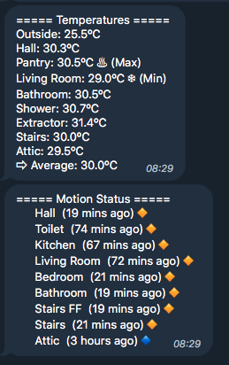

    } else if (TelegramMenuCommandString.state == 'TEMPS') {
        .... Code preparing status response here ....
        sendTelegram("TelegramBot", TemperaturesStr)
    } else if (TelegramMenuCommandString.state == 'STATUS') {
        sendTelegram("TelegramBot",  StatusStr)

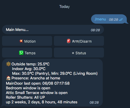

That is all I need. If I issue a /menu command to the Telegram chat with my bot the python script answers with a buttons keyboard, containing 2 rows of 2 buttons (can contain more lines or rows at will) and whenever I press one of the buttons an action gets executed within my OpenHAB installation. Simple and very useful for me
