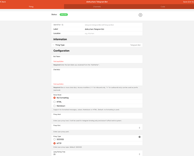

Hi, I have set up a Telegram bot successfully (I can send messages via an http call).
However, the sendTelegram command executed in a rule (filename “telegramtest.rules”) copied from the documentation results in an error:
The rule is:
rule "Send telegram with question"
    Item HUEMotionSensorWohnzimmer_Bewegung changed
    val telegramAction = getActions("telegram","telegram:telegramBot:telegram:telegramBot:dKTelegramBot")
    telegramAction.sendTelegramQuery("No one is at home, but some lights are still on. Do you want me to turn off the lights?", "Reply_Lights", "Yes", "No")
When the rule is triggered, the “telegramAction.sendTelegramQuery” results in the following error:
2022-01-22 20:23:22.580 [ERROR] [internal.handler.ScriptActionHandler] - Script execution of rule with UID 'telegramtest-1' failed: null in telegramtest
The code from the THING is:
UID: telegram:telegramBot:dKTelegramBot
label: dieKuchars Telegram Bot
thingTypeUID: telegram:telegramBot
configuration:
  proxyType: HTTP
  longPollingTime: 25
  parseMode: ""
  chatIds:
  botToken: -
The Telegram THING is active and looks good (note, I have deleted the IDs in this picture):
Any idea what is wrong?
You maybe should delete the token within your post
Better try:
    val telegramAction = getActions("telegram","telegram:telegramBot:dKTelegramBot")
instead:
Thx Jens, it worked! I read the docu wrong then…
thx a lot.
