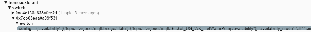

I can’t really help with zigbee2mqtt issues except vague suggestions to look and see if those topics exist on the broker. Maybe if they don’t exist OH can’t discover them?
Since it’s MQTT you can do anything. But you won’t be able to use HomeAssistant discovery. You’ll have to create and configure a Generic MQTT Thing.

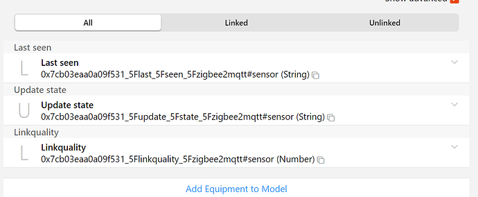

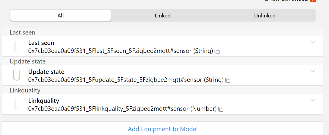

OH discover the thing with all the possible channels.
But OH doesn’t activate alle the channels.

All topics are available. So its not an issue with the mqtt broker…
Why OH doesn’t add all channels …

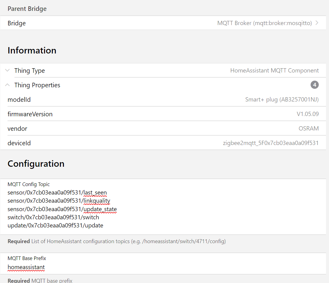

What are the channel configs in JSON?
For example: Looking at the issue in github I see one device switch has “ON”, “OFF” & “Toggle”. That is not going to work with a Switch item (IMO).

It is not going to survive the rigorous channel verification. My guess is that’s why it is not appearing as channel but is on the UI tab as a config. I am puzzled by the lack of a log entry, but some of the very early validation routines (in early 2022) were at the debug level.
