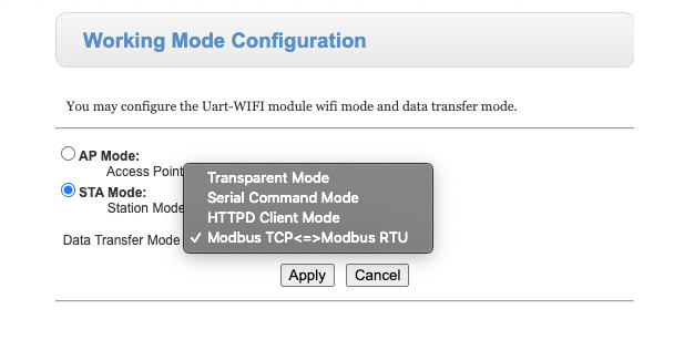

- USR-W610 Gateway in STA Mode and Data Transfer Mode “Modbus TCP <==> Modbus RTU”.

Is anyone using USR-W610 in the same setup and having issues?
ModBus Variables values are coming in but quite often I get this COMMUNICATION ERRORs as above and everything stops working after a while.
