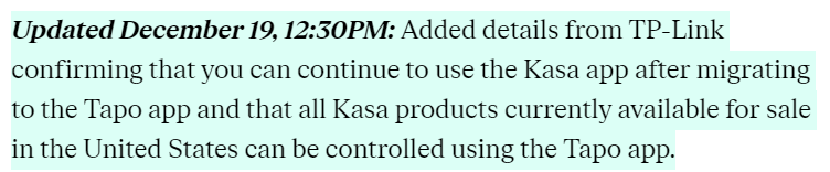

If “this guy” refers to me, note that there was a correction in the linked article from The Verge.
I didn’t re-read the article when I made my previous comment, so I was under the wrong impression when I wrote:
I’ll edit my comment to correct this.
