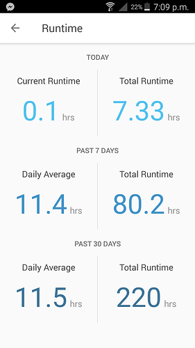

When you use the KASA app you get a little readout of runtime
where are these values stored? are they stored inside the sockets themselfs? and is there a way too access these or recreate in OH?
These values are stored in the socket and can be retrieved via the api. The openHAB binding doesn’t retrieve them. However openHAB can persist channel data with an interval and can be used to basically do the same and more: you can generate nice graphics. Because of this functionality I’m not sure if there is much added value to get those statics directly from the socket. Actually in the first reply in this topic and extensive configuration example is give that includes storing statics in openHAB and show them with a chart.
