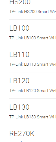

I went to Inbox → Clicked ā€˜+’ → TP-Link Smart Home Devices Binding → Add Manually
But the LB230 bulb is not listed:

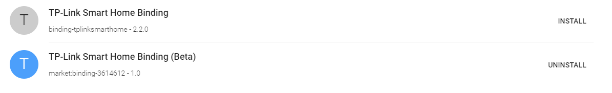

As mentioned previously I installed the (Beta) version of the TP-Link binding from the marketplace.
I checked the Karaf console and it reports that I have v2.3.0.201712262051 installed.
I guess this explains why my LB230 bulbs were not detected but why do they not show in the device list?

It looks like you got a incorrect version of the binding. For the eclipse market place I use the binding build by the openHAB pull request builder. When this binding was not yet part of openHAB this is worked fine as my pr was the only one that created this binding. But now that the binding is part of openHAB it can also be overridden by to other pr’s that only contain what is part of openHAB, (which is not any new code I added that is not part of openHAB). I should probably change this in the future and use another location to store the jar.
The good news is that the pr with new devices support has been merged already, you can use or an openHAB snapshot version of the jar or reinstall the eclipse market place jar.

Did this and tried again, auto-detection of my LB230 bulbs worked as did adding manually in the things file using the lb230 device type. Thanks! :smiley:
