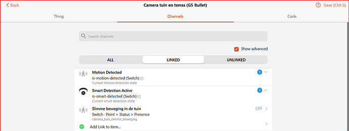

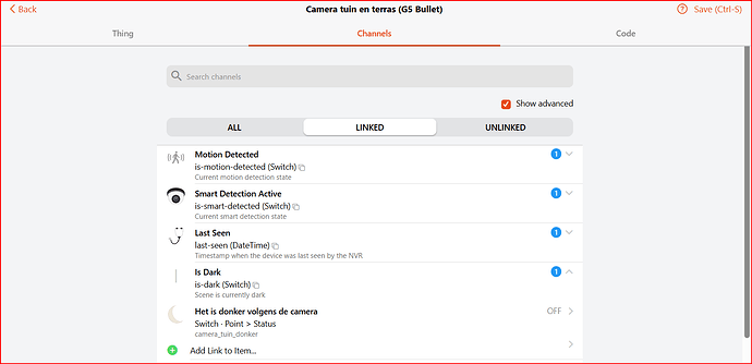

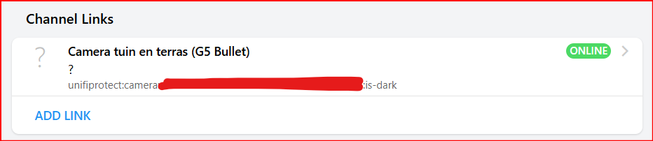

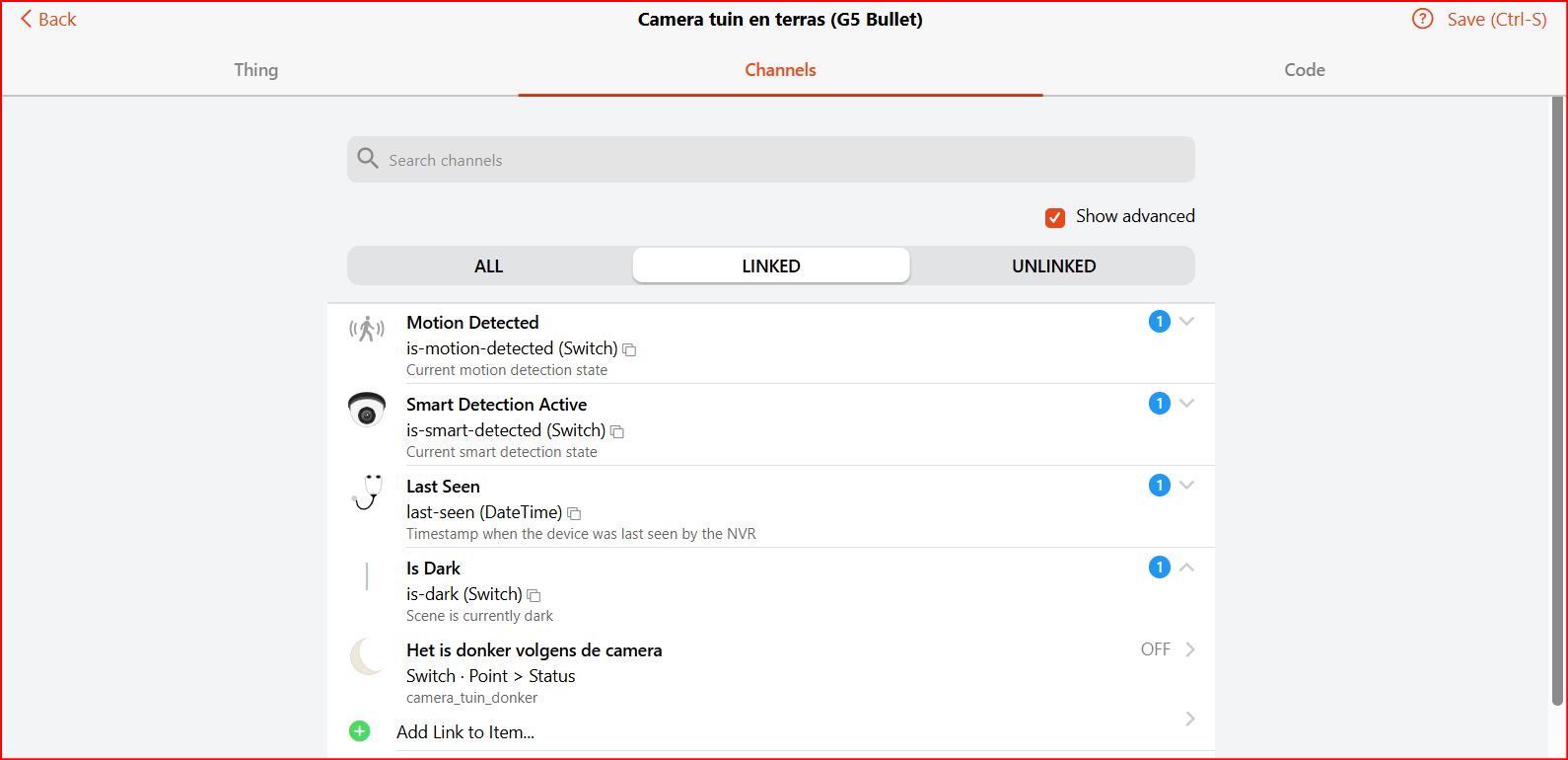

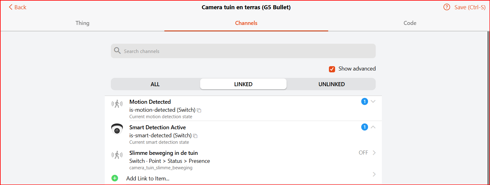

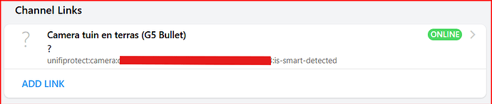

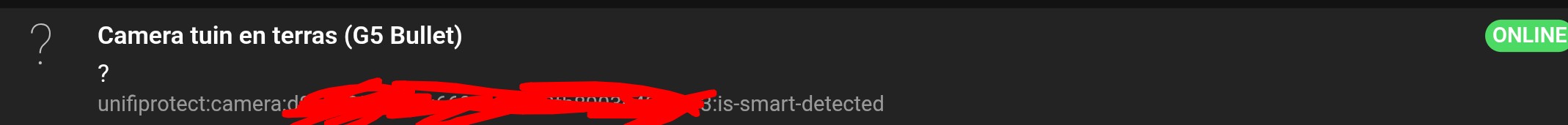

@digitaldan, this question mark seems odd?
Its hard to see with only a partial screenshot and no description, Can you elaborate where you are seeing this and maybe a little more of the UI ? I think its a channel description, but the online status seems odd there. In any case it seems like it trying to load a missing icon for the openHAB channel semantic tag, but i’m not seeing that on my system.

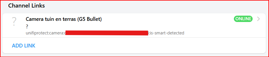

Apologies, I thought that would have been enough. Also, I was on my phone, which is less convenient for screen shots.
It shows a Channel Link, from an Item UI view. Some more detail:
When looking at it from the Thing UI view, there’s an icon:

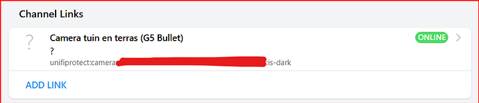

But where there’s an I for is-dark:
… there’s also ? in the Item UI view (although now there’s no icon to be loaded, just a letter I):
These are just semantic tags issues with the Main UI for those couple of more advanced channels, they don’t affect the functionality at all of the binding or channel. I’ll see if i can update the xml description for those channels next time i make an update to something else in the binding.
I didn’t assume there were any functional problems. But I reckon you like to dot the i’s and cross the t’s :wink:
