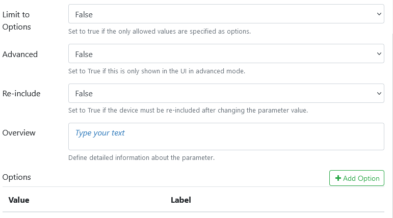

In addition, you could add options for 0 and 1 to parameters 2, 5, 6 and enable ā€œ'Limit to optionsā€:
The XML worked fine once I grabbed the right one!
I’ll go back and revise the parameter section
