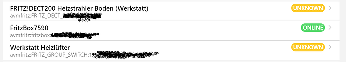

Now my AVMFRITZ items show UNKNOWN under the ‘Things’ section in OpenHAB3 and do not work anymore. In OpenHAB2 I did not have any problems.
openHAB3_AVMFritz

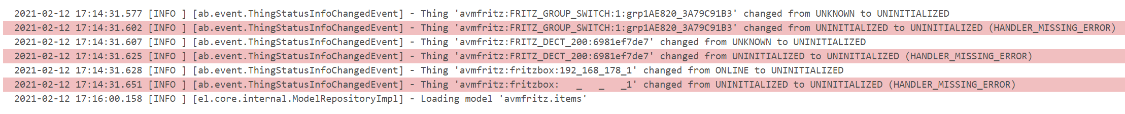

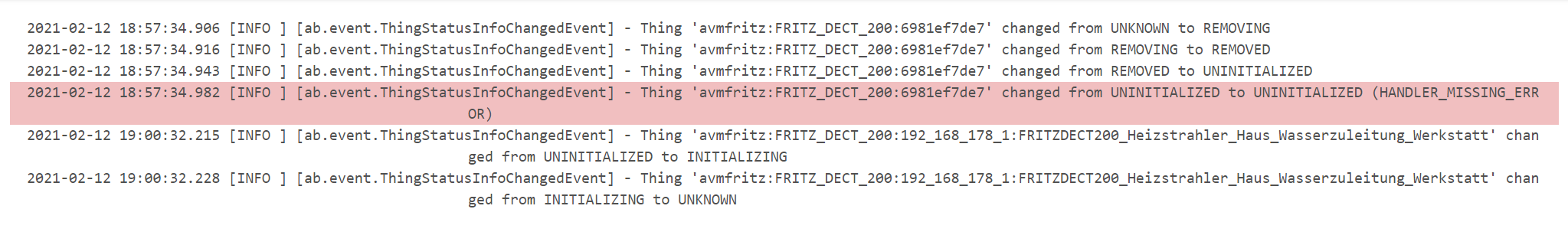

If I restart the openhab service frontails shows this:
openhab3_AVMFRITZ_tail

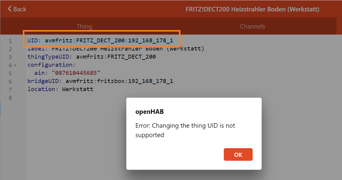

i compared the picture with my installation an found the following:
  • the identifier of your fritzbox is avmfritz:fritzbox:IP-Number
    (mine too, because added via UI)
The DECT200 device references a number 6981… and not the IP-Number of your fritzbox, mine all do.
Hi @hare0815 ,

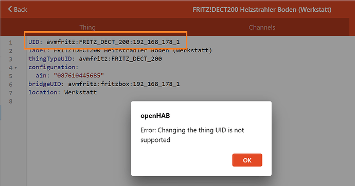

thanks, I used OH3 to edit the FritzDect200 thing using the new Code area, to enter the IP-Address as you suggested. But if I hit ‘Save (CTRL-S)’ I get this error:
openHAB3_FritzDect200
you have to add the ain-number at the end of the UID!
It should be avmfritz:FRITZ_DECT_200:192_168_178_1:087610…, if this is the correct ain-number of the device.

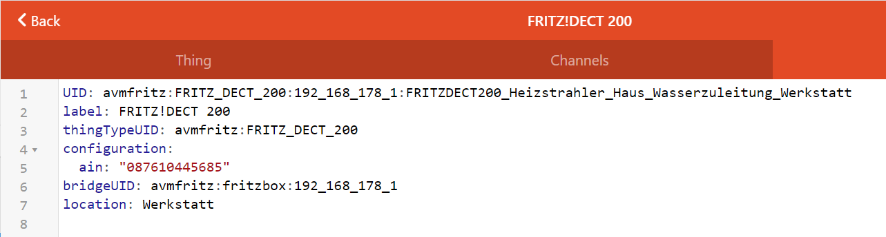

If you add the device via the UI (Things / + / AVM Fritz!Binding / Scan) you don’t have to edit this fields, the binding will create that for you.
Now I deleted the Thing using the new OH3 UI and added the FritzDect200 back.
Now I got this:
openHAB3_FritzDect200_2
And this is ehat frontails says after deleting and adding:
openhab3_AVMFRITZ_tail_2

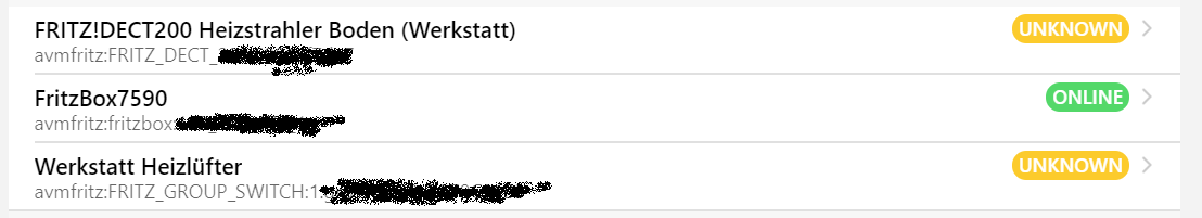

And the ‘thing’ is still presented as UNKNOWN :frowning:
After deleting and re-adding the FritzDect200 like mentioned in my previous post I restarted the OpenHAB-service using:
sudo systemctl restart openhab.service
And now my FritzDect200 is online again - yeeaaahhh
