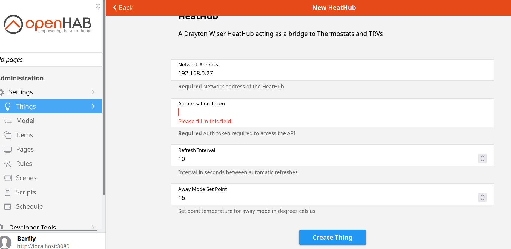

Drayton are deleting their MyGenie app in March rendering my system unable to change any schedules from that date. I wish to create a simplified app that can interface with the miGenie gateway G104M to allow this.
I am stuck on getting an Authorisation token as in the screenshot here:-
![Screenshot_20231102_172914|690x337](upload://mXqQEFug7fy0Ys5wcPHQpEIhIte.jpeg)
The information I have been able to glean on this website is only for the replacement Wiser sytem.
Am I flogging a dead horse here? Is what I want to achieve possible?

I don’t know these systems so won’t be of much help. I don’t see any miGenie add-on so without some sort of published API information integration is unlikely.
But your screen shot didn’t come through. It looks like you accidentally posted it inside code fences.

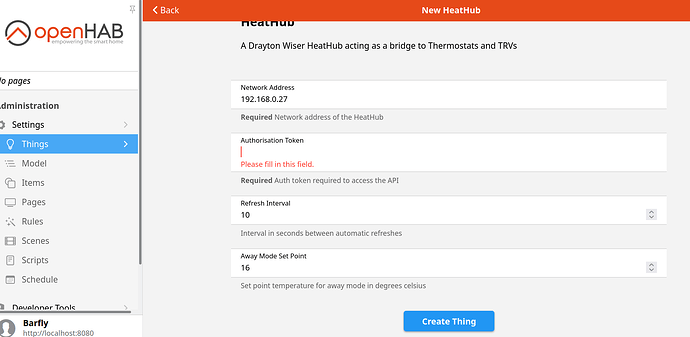

Thanks for the reply @rlkoshak
Hope this comes out.
Tony
OK, the docs indicate that you need to install a network sniffer (e.g. Wireshark) to capture a packet from messages between the system and the app. From this you can extract the secret.
But the binding only talks about Wiser so it might be this integration isn’t possible.
In either way, it’s clearly not an officially supported integration.

Based on the docs, nope. You’ll have to sniff the traffic to find the secret token. And there is no guarantee that it works the same between Wiser and miGenie.
But someone obviously got something to work, given the add-on exists at all.
I can’t find anyone having attempted an integration with the Drayton MiGenie device - just a couple of people asking about it for other systems.
You’re trying to use the Drayton Wiser binding, and the Wiser (which has been around a while) appears to be the successor to this device. There’s always the possibility they use the same or similar API calls, but I wouldn’t put money on it (or why is MiGenie shutting down but not Wiser?). As Rich suggests, you could try sniffing what the app does, and how it connects to the device (e.g. it might always go through the cloud, hence why it’s shutting down, or like the Wiser it might also go direct to the device when it’s on the same network). The Wiser has a HTTP API on the device which you access when it’s in setup mode to get the API token, I’d see if the instructions here make sense for your device and give it a try?
Given the device is being phased out, you might find other people in similar situations driven to build an integration, but considering nobody has to date I guess the demand might be low. You could also ask Drayton for API docs?
