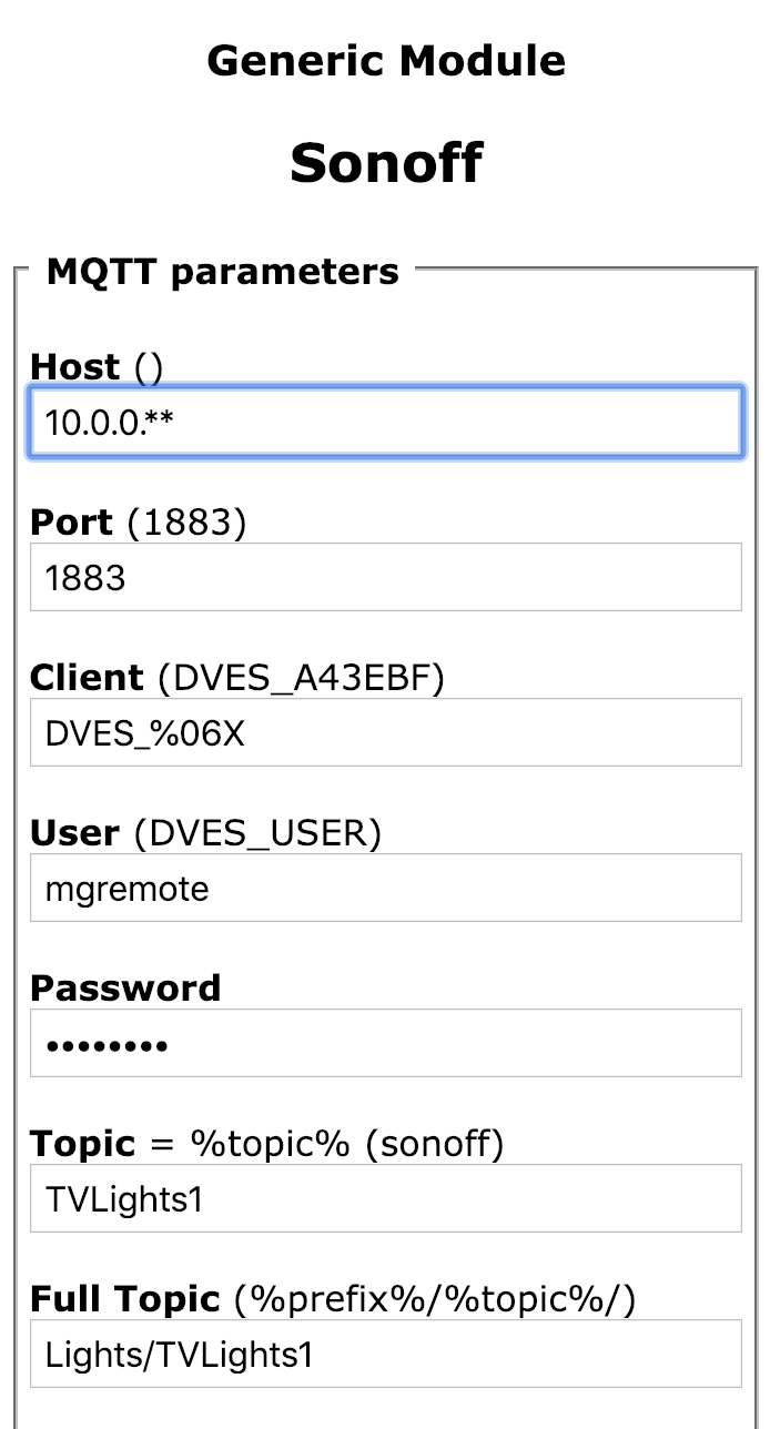

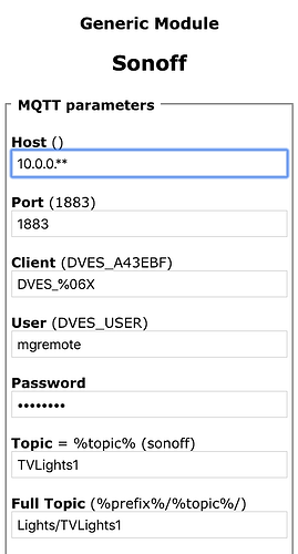

Please show a screenshot showing the mqtt page of one sonoff switch.

Here’s the screenshot:
