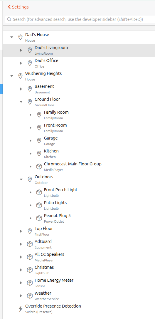

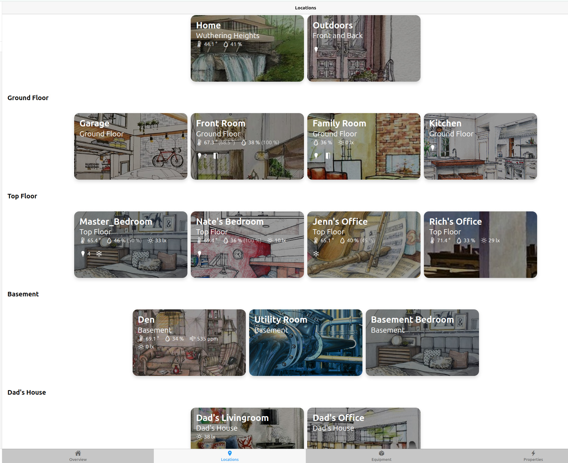

But I can say how I do it. I have two locations, my home and my dad’s home. So I created one house location for my dad’s house and put all the Items at that location under it and another house location for my home.
My home has some inside stuff and some outside stuff and three floors. So I modeled the outside same as one of the floors.
But this is just one way to do it and it’s what works for me. You need to figure out what works best for you or whether you even need the semantic model at all.
The model controls how the cards on the Locations, Equipment, and Properties are organized. This is the most common reason to use the model and therefore you’ll set up your model based on how you want to have the cards on these pages organized. In my case, it keeps my dads house separate from my house.
