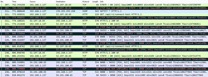

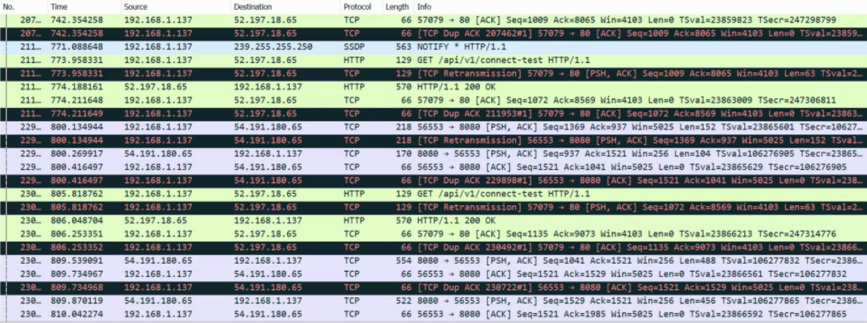

The next trick is to receive events from the AC when, for example, a user changes state with the physical remote control.
The AC sends a flurry of statements to amazon cloud services directly after its status changes.
Small example:
So, we don’t actually need to know what’s in the packet, as we can just query the device, but somehow we need to be able to know when this communication has happened, and that is our event, to query the AC.
Need some stronger brains to help with this bit!

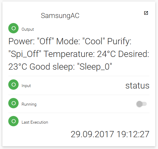

Meanwhile the binding is in progress, I made a shell script to controll my Samsung Air Conditioner (new version with port 8888) This is added as Exec binding:
root@raspberrypi:/usr/share/openhab2/samsungac# cat control_samsungac.sh

Rules example:
rule "Samsung AC night"
                                Time cron "0 0 23 ? * MON-SUN"
        sendCommand(SamsungAC_Input, "power on")
        Thread::sleep(5000)
        sendCommand(SamsungAC_Input, "temperature 24")
        Thread::sleep(5000)
        sendCommand(SamsungAC_Input, "purify on")
        Thread::sleep(5000)
        sendCommand(SamsungAC_Input, "goodsleep 2")
Of course you can another IP address, another path to cert file, and another token key (mine is r42iV2EQ1c)
