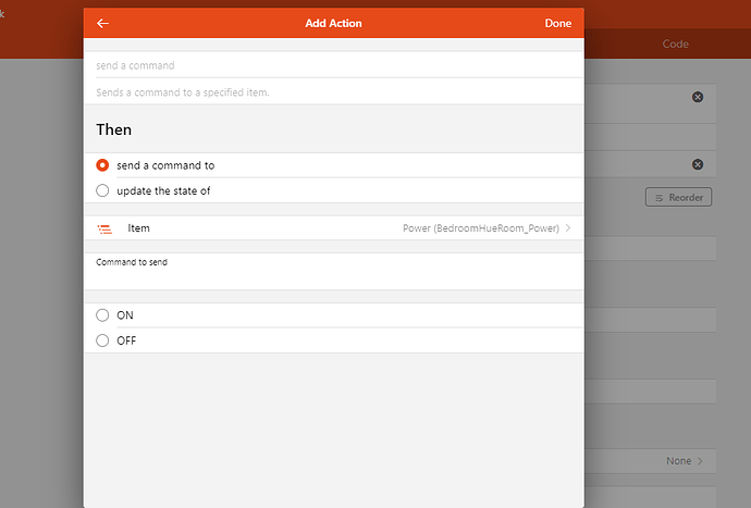

I love the UI rules in OH3 - these are so easy to read, write and manage. I was looking to write a rule to sync my wifi plugs to my hue lights - I know this can be few lines of codes in rule DSL with newState, etc. but in the UI rules, newState doesn’t seem to be there. Would there be another easy way to copy state changes of one switch with another one?
Do you refer to the blocklies and event.newState? Then the answer is “soon”. I have just implemented it and it is waiting to be reviewed and therefore released soon.
In that case no, that’s not supported and I know of no one who is working on support for that. code less rules are intended to be for only the most very basic of rules. If we add all the little “but can we do this, and what about adding that” type stuff to it it doesn’t take too long before we end up with Blockly anyway.
Not correct. Make a rule. Under “Then” choose “Run Script” and from there choose “Design with Blockly”. It’s rare that one would write a rule that calls other rules. That’s creating a Script Action. Calling another rule (e.g. something listed under Settings → Scripts) is done by choosing “Other rules” as the action.

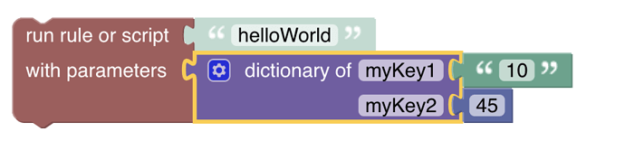

and then create a script named “helloWorld” and add the following code
logger.info('helloWorld was called')
logger.info('Params are='+context.getAttribute('myKey1'))
logger.info('Params are='+context.getAttribute('myKey2'))
When triggering the blockly rule you will see the following in the log
[org.openhab.rule.helloWorld ] - helloWorld was called
[org.openhab.rule.helloWorld ] - Params are=10
[org.openhab.rule.helloWorld ] - Params are=45
Btw, I am also a pretty experienced Java Developer and used DSL rules for quite a number of rules but I moved to the blocklies for many of my rules (not saying all) because most of the rules are rather simple and in these case the blocklies have the big advantage that you can build them very quickly whereas with DSLs can you can easily end up having syntax errors or typos. So for “simple” stuff (even though complex things are doable) I used the blocklies, for complex things I keep my DSLs.
PS: @rlkoshak Maybe we should add a Block that allows to get context-values (context getAttribute) because then we could have even written the script with blocklies. What do you think?
