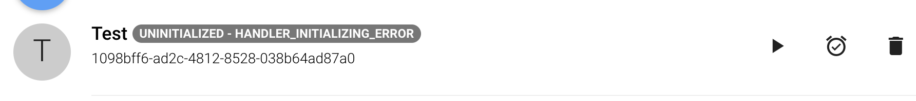

When I add “It is a weekend” the rule is “UNINITIALIZED - HANDLER_INITIALIZING_ERROR”. The same problem occours when I use “It is a weekday”.
Screenshot from the rule:
Screenshot from the error:
In the events.log I found this error message:
2020-10-17 17:56:36.959 [.event.RuleStatusInfoEvent] - 1098bff6-ad2c-4812-8528-038b64ad87a0 updated: UNINITIALIZED (HANDLER_INITIALIZING_ERROR): Getting handler 'ephemeris.WeekendCondition' for module '3' failed: Config parameter 'offset' is missing in the configuration of module '3'.
After this I changed the offset in the rule from nothing to “0”. But the error occours again.

I don´t know if it should be "type": "ephemeris.isWeekend".
I created the rule in the PaperUI and the system itselfs created the rule in the .json file.
When I change it in the “automation_rules.json” the rule through still the error “UNINITIALIZED - HANDLER_INITIALIZING_ERROR”.
