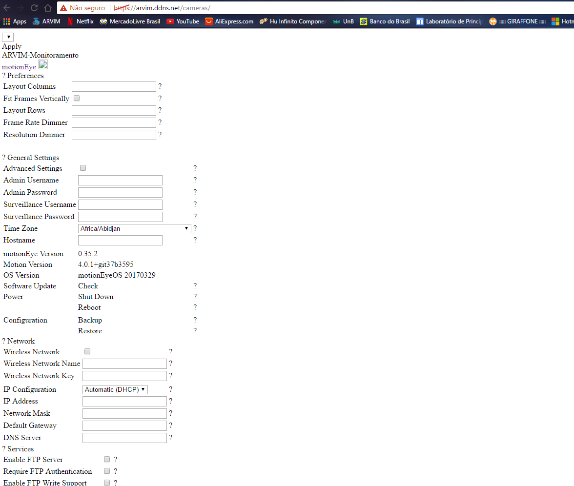

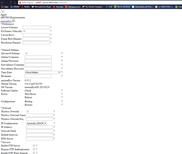

i need some help and i like the openhab community for my issues everyone is friendly and helpful in assisting in issues. and this is more a me and nginx issue than anything. i got nginx up and running with HTTPS i am now secure with password authentication for my openhab service. what i cant figure out now and I have been searching and trying, but i just dont understand how to add my motionEyeOS server to the nginx server. i think it is mostly my lack of knowledge, but what i want to accomplish is if i go to example.com it launches openhab (which works currently) and then if i want to go to motionEyeOS it would be example.com/cameras. i tried a few different things, but only one actually produced anything and it was the site in what looks like text form i have attached my sites-enabled config and then an example of the webpage load i received.

## location /cameras/ {
## proxy_pass http://10.0.0.50/;
## proxy_read_timeout 120s;
## access_log off;

the page i received as a result of above
