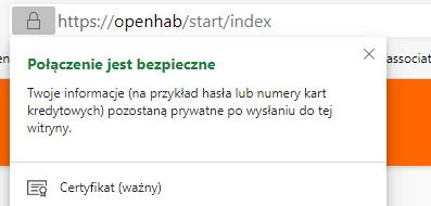

Now clear casche from webbroweser and use proper address to be able to reach your openhab serwer - https://openhab in my example.
