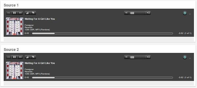

Hi Mark,
… it’s a long time - but today I’ve found some time to experiment if I could address the issue you’ve found differently; as my updated setup suffers from the same issue you described. I do not have the option to change the DNS configuration & I use the web interface via OH exclusively. Thus I’ve decided to updated the .html page of SqueezeBox-Server :-).
If of interest I can post more details; here a general overview:
