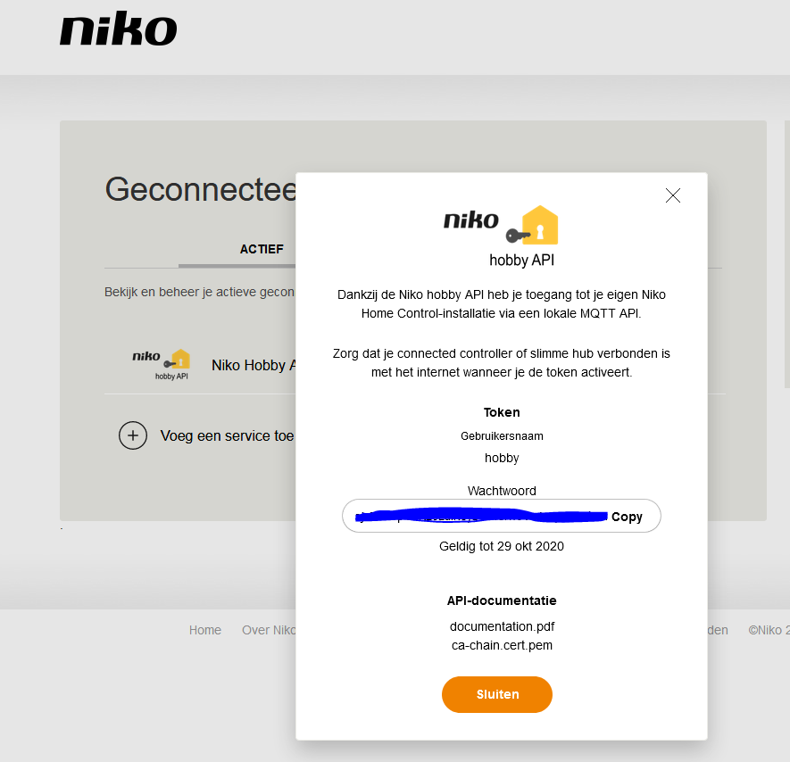

This morning, the Niko Home Control hobby API went live. Binding will get adapted soon after testing.
