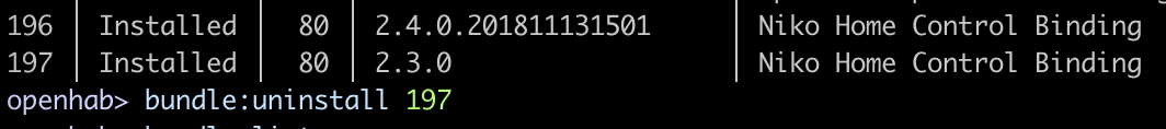

Used a clean install. Saw 2 Niko Home Control Bindings installed. Uninstalled the 2.3.0 version.
