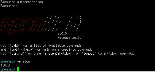

Hi Mark,
the version in the meantime i will get the full debug log:
BR.
Marek.
