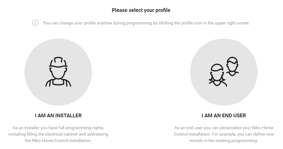

I see that the programming software for v2 is available now!
more info: Niko Home Control
@wars Yes, the upgrade will be possible, but only if you replace your controller and IP gateway with a connected controller, which I am not prepared to do in my own setup if it is not broken.
Nice you would be able to test on v2. We could then verify if it work, and if not, try to get a solution.
There is already an NHCII app available as well. What worries me is that you need to login, so it seems to go to the cloud service for connecting. The local communication as I have it right now may not be possible anymore. The description on the Niko website also states both connected controller and app need to be connected to the internet.
Correct, BUT they also write that from april 2018, v1 programs can be converted to v2. So local communication should still be possible… time will tell :slight_smile:
new application will also be the ‘end user’- software. An extra nice feature: up to 50 (previous) versions will be saved to the (connected) controller.
