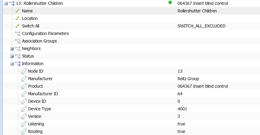

I have bought some Z-wave Rollershutter control relay - Model Düwi 05436 (ZME_05436) and have some problem in Habmin:
I can not access any Configuration parameters or association groups of
this relay - the sections are empty. See attached screenshot.
There is a strange thing, that relay is recognized as 064367, while the
label suggests different type. In principle it’s the same, but might
cause a problem.
The version of Habmin is 0.1.3-snapshot. The version of Z-Wave Binding is 1.8.2.
I need to change open and close times in order to control Shutter position correctly, but I can not do this due to this problem.
Any hints? OR is it possible to change relay configuration outside Habmin?
