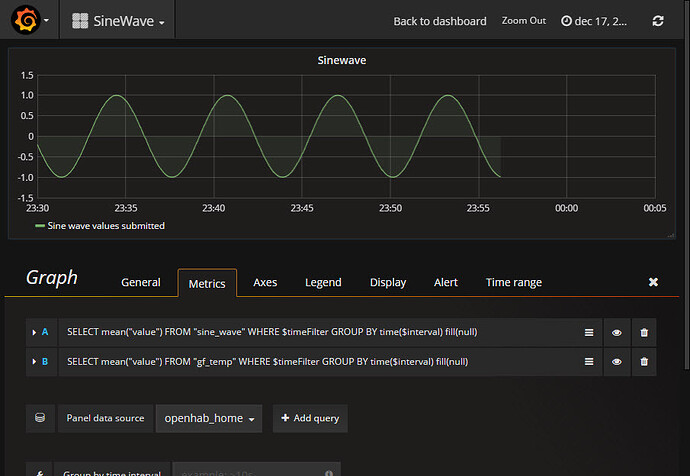

I have installed InfluxDB 1.1.1 and Grafana 4.0.2. I am using Persistence in OpenHAB2 to log data from my temperature loggers.

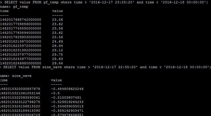

Data is updated into my “openhab_db” database in InfluxDB, I can query data from InfluxDB by using select * from… in Grafana I get no erros but a message saying “No datapoints”.
I have in the same time interval, the sine.py script running (from this excellent tutorial: InfluxDB+Grafana persistence and graphing) and that data I can access and see in Grafana.
In Grafana I have made this configuration, It’s the second Query that fails:
I am no expert in OH and databases, but the one thing that looks different is the “timestamp”, where the logdata from OH ends on a lot of Zero’s and timestamps from the sine.py script is filled out with numbers.
I am running the installation on a Raspberry Pi 3, OH, InfluxDB and Grafana.
It’s probably a beginner’s mistake, I hope there is someone who can get me closer to a sloution.

I have been looking more into this, and the problem was, I think, that I have made a string item and wanted to show that in Grafana.
I’ve changed it to a number and it still did’nt work until I deleted the series in influxdb (probably because of a mix of data stored as string and numbers.
But It is working now :slight_smile:
