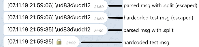

I added a screenshot: 3rd line is parsed like in the example above, 4th line is hardcoded like in the xample above. Line 1 and 2 are escaped like you mentioned. It changes nothing with the parsed message, but does not parse the emoji in the hardcoded example anymore.
