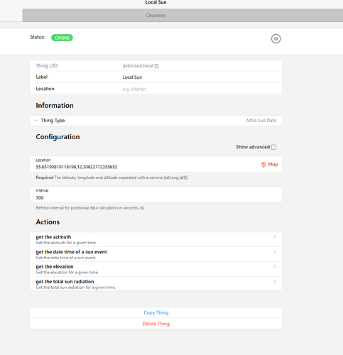

Podman running openhab:latest. I used to have astro stuff and rules configured in files but it stopped working for some reason after I migrated bare-metal to container so now trying to do it strictly from the UI and failing.
  1. Deleted all things and binding from files and uninstalled binding
  2. Re-installed binding and configured coordinates
  3. Sun and Moon things were discovered and added as things. Channels are populated
  4. Log level for the binding set to debug
It seems to have installed just fine and it initializes on restart but I am seeing nothing in the event log after initialization:

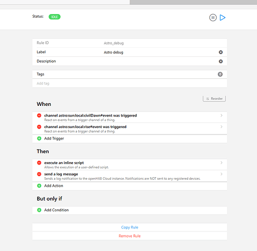

I’ve tried to create a simple test rule and it doesn’t fire either:
I must be missing something obvious since I can’t seem to find others posts with these symptoms but what? I’ve done everything via the UI.

If there’s nothing listening for it there won’t be an event. Your rule listens for civlDawn and rise so I would only expect to see those two events anywhere.
And I’m not sure that Thing event channel events get logged to events.log by default so you might not even see them at all unless you change the lower level of openhab.events.ChsnnelEvent (if I recall correctly). It might be possible channel events don’t go on the event bus at all.
The events are scheduled at the same time as the Items are updated. If you link a state channel to an item, does the Item get a state or dues it remain NULL?

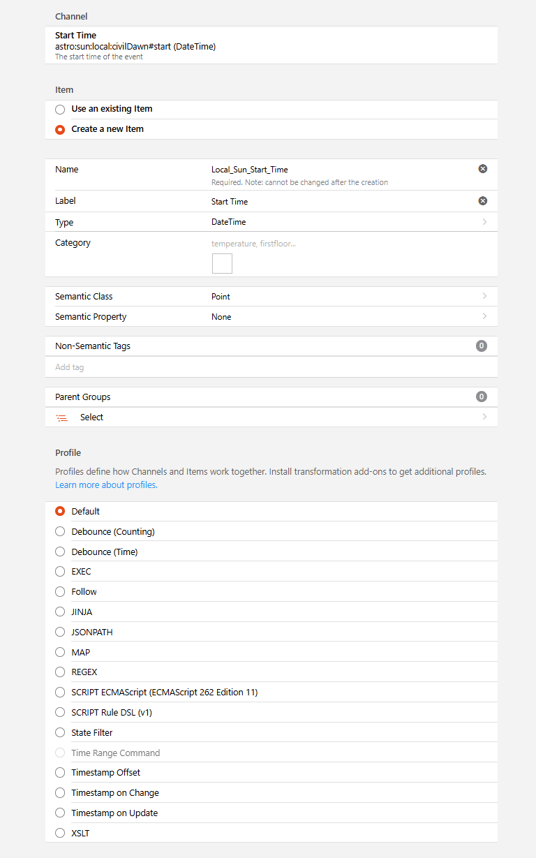

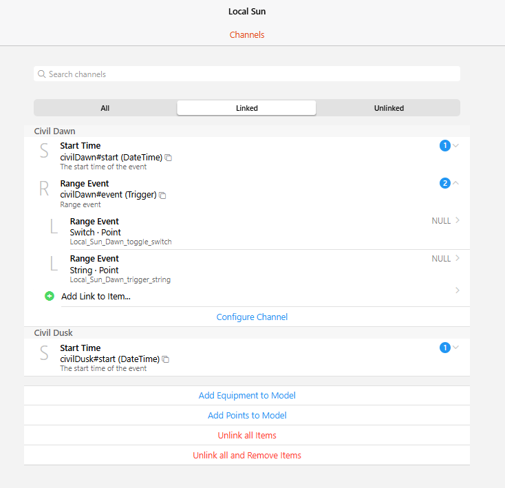

My rule still didn’t trigger, even with an item linked, and no event in the log for CivilDawn START:
2025-03-02 00:00:30.687 [INFO ] [openhab.event.ItemStateChangedEvent ] - Item 'AstroCivilDawnStart' changed from 2025-03-01T06:26:00.000+0100 to 2025-03-02T06:24:00.000+0100
2025-03-02 00:00:30.687 [INFO ] [openhab.event.ItemStateChangedEvent ] - Item 'AstroCivilDuskStart' changed from 2025-03-01T17:46:00.000+0100 to 2025-03-02T17:48:00.000+0100
2025-03-02 00:00:30.576 [DEBUG] [o.internal.handler.AstroThingHandler] - Publishing planet Moon for thing astro:moon:local                                                                                                       2025-03-02 00:00:30.577 [DEBUG] [enhab.binding.astro.internal.job.Job] - Scheduled Astro event-jobs for thing astro:moon:local                                                                                                   2025-03-02 00:00:30.577 [DEBUG] [o.internal.handler.AstroThingHandler] - Scheduled Event job astro:moon:local/rise#event/START in 27509423ms (at 2025-03-02T07:39:00)                                                            2025-03-02 00:00:30.577 [DEBUG] [o.internal.handler.AstroThingHandler] - Scheduled Event job astro:moon:local/set#event/END in 78209423ms (at 2025-03-02T21:44:00)                                                               2025-03-02 00:00:30.686 [DEBUG] [o.internal.handler.AstroThingHandler] - Publishing planet Sun for thing astro:sun:local                                                                                                         2025-03-02 00:00:30.687 [DEBUG] [enhab.binding.astro.internal.job.Job] - Scheduled Astro event-jobs for thing astro:sun:local                                                                                                    2025-03-02 00:00:30.687 [DEBUG] [o.internal.handler.AstroThingHandler] - Scheduled Event job astro:sun:local/rise#event/START in 25229313ms (at 2025-03-02T07:01:00)                                                             2025-03-02 00:00:30.687 [DEBUG] [o.internal.handler.AstroThingHandler] - Scheduled Event job astro:sun:local/rise#event/END in 25469313ms (at 2025-03-02T07:05:00)                                                               2025-03-02 00:00:30.687 [DEBUG] [o.internal.handler.AstroThingHandler] - Scheduled Event job astro:sun:local/set#event/START in 63809313ms (at 2025-03-02T17:44:00)                                                              2025-03-02 00:00:30.687 [DEBUG] [o.internal.handler.AstroThingHandler] - Scheduled Event job astro:sun:local/set#event/END in 64049313ms (at 2025-03-02T17:48:00)                                                                2025-03-02 00:00:30.687 [DEBUG] [o.internal.handler.AstroThingHandler] - Scheduled Event job astro:sun:local/noon#event/START in 44609313ms (at 2025-03-02T12:24:00)                                                             2025-03-02 00:00:30.687 [DEBUG] [o.internal.handler.AstroThingHandler] - Scheduled Event job astro:sun:local/noon#event/END in 44669313ms (at 2025-03-02T12:25:00)                                                               2025-03-02 00:00:30.687 [DEBUG] [o.internal.handler.AstroThingHandler] - Scheduled Event job astro:sun:local/night#event/START in 71429313ms (at 2025-03-02T19:51:00)                                                            2025-03-02 00:00:30.687 [DEBUG] [o.internal.handler.AstroThingHandler] - Scheduled Event job astro:sun:local/morningNight#event/START in -30687ms (at 2025-03-02T00:00:00)                                                       2025-03-02 00:00:30.687 [DEBUG] [o.internal.handler.AstroThingHandler] - Scheduled Event job astro:sun:local/morningNight#event/END in 17849313ms (at 2025-03-02T04:58:00)                                                       2025-03-02 00:00:30.687 [DEBUG] [o.internal.handler.AstroThingHandler] - Scheduled Event job astro:sun:local/astroDawn#event/START in 17849313ms (at 2025-03-02T04:58:00)                                                        2025-03-02 00:00:30.687 [DEBUG] [o.internal.handler.AstroThingHandler] - Scheduled Event job astro:sun:local/astroDawn#event/END in 20429313ms (at 2025-03-02T05:41:00)                                                          2025-03-02 00:00:30.687 [DEBUG] [o.internal.handler.AstroThingHandler] - Scheduled Event job astro:sun:local/nauticDawn#event/START in 20429313ms (at 2025-03-02T05:41:00)                                                       2025-03-02 00:00:30.687 [DEBUG] [o.internal.handler.AstroThingHandler] - Scheduled Event job astro:sun:local/nauticDawn#event/END in 23009313ms (at 2025-03-02T06:24:00)                                                         2025-03-02 00:00:30.687 [DEBUG] [o.internal.handler.AstroThingHandler] - Scheduled Event job astro:sun:local/civilDawn#event/START in 23009313ms (at 2025-03-02T06:24:00)                                                        2025-03-02 00:00:30.687 [DEBUG] [o.internal.handler.AstroThingHandler] - Scheduled Event job astro:sun:local/civilDawn#event/END in 25229313ms (at 2025-03-02T07:01:00)                                                          2025-03-02 00:00:30.687 [DEBUG] [o.internal.handler.AstroThingHandler] - Scheduled Event job astro:sun:local/astroDusk#event/START in 68849313ms (at 2025-03-02T19:08:00)                                                        2025-03-02 00:00:30.687 [DEBUG] [o.internal.handler.AstroThingHandler] - Scheduled Event job astro:sun:local/astroDusk#event/END in 71429313ms (at 2025-03-02T19:51:00)                                                          2025-03-02 00:00:30.687 [DEBUG] [o.internal.handler.AstroThingHandler] - Scheduled Event job astro:sun:local/nauticDusk#event/START in 66269313ms (at 2025-03-02T18:25:00)                                                       2025-03-02 00:00:30.687 [DEBUG] [o.internal.handler.AstroThingHandler] - Scheduled Event job astro:sun:local/nauticDusk#event/END in 68849313ms (at 2025-03-02T19:08:00)                                                         2025-03-02 00:00:30.687 [DEBUG] [o.internal.handler.AstroThingHandler] - Scheduled Event job astro:sun:local/civilDusk#event/START in 64049313ms (at 2025-03-02T17:48:00)                                                        2025-03-02 00:00:30.688 [DEBUG] [o.internal.handler.AstroThingHandler] - Scheduled Event job astro:sun:local/civilDusk#event/END in 66269312ms (at 2025-03-02T18:25:00)                                                          2025-03-02 00:00:30.688 [DEBUG] [o.internal.handler.AstroThingHandler] - Scheduled Event job astro:sun:local/eveningNight#event/START in 71429312ms (at 2025-03-02T19:51:00)                                                     2025-03-02 00:00:30.688 [DEBUG] [o.internal.handler.AstroThingHandler] - Scheduled Event job astro:sun:local/daylight#event/START in 25469312ms (at 2025-03-02T07:05:00)
2025-03-02 00:00:30.688 [DEBUG] [o.internal.handler.AstroThingHandler] - Scheduled Event job astro:sun:local/daylight#event/END in 63809312ms (at 2025-03-02T17:44:00)                                                           2025-03-02 00:00:30.688 [DEBUG] [o.internal.handler.AstroThingHandler] - Scheduled Sun phase job astro:sun:local/SUN_RISE in 25229312ms (at 2025-03-02T07:01:00)                                                                 2025-03-02 00:00:30.688 [DEBUG] [o.internal.handler.AstroThingHandler] - Scheduled Sun phase job astro:sun:local/SUN_SET in 63809312ms (at 2025-03-02T17:44:00)
2025-03-02 00:00:30.688 [DEBUG] [o.internal.handler.AstroThingHandler] - Scheduled Sun phase job astro:sun:local/NIGHT in 71429312ms (at 2025-03-02T19:51:00)                                                                    2025-03-02 00:00:30.688 [DEBUG] [o.internal.handler.AstroThingHandler] - Scheduled Sun phase job astro:sun:local/DAYLIGHT in 25469312ms (at 2025-03-02T07:05:00)
2025-03-02 00:00:30.688 [DEBUG] [o.internal.handler.AstroThingHandler] - Scheduled Sun phase job astro:sun:local/ASTRO_DAWN in 17849312ms (at 2025-03-02T04:58:00)                                                               2025-03-02 00:00:30.688 [DEBUG] [o.internal.handler.AstroThingHandler] - Scheduled Sun phase job astro:sun:local/NAUTIC_DAWN in 20429312ms (at 2025-03-02T05:41:00)                                                              2025-03-02 00:00:30.688 [DEBUG] [o.internal.handler.AstroThingHandler] - Scheduled Sun phase job astro:sun:local/CIVIL_DAWN in 23009312ms (at 2025-03-02T06:24:00)                                                               2025-03-02 00:00:30.688 [DEBUG] [o.internal.handler.AstroThingHandler] - Scheduled Sun phase job astro:sun:local/ASTRO_DUSK in 68849312ms (at 2025-03-02T19:08:00)                                                               2025-03-02 00:00:30.688 [DEBUG] [o.internal.handler.AstroThingHandler] - Scheduled Sun phase job astro:sun:local/NAUTIC_DUSK in 66269312ms (at 2025-03-02T18:25:00)                                                              2025-03-02 00:00:30.688 [DEBUG] [o.internal.handler.AstroThingHandler] - Scheduled Sun phase job astro:sun:local/CIVIL_DUSK in 64049312ms (at 2025-03-02T17:48:00)
Mvh.
Torkil
The Item trigger would never work as written anyway. An Item linked to one of the State Channels must be a DateTime Item and about ten seconds after midnight (or when OH first starts) the time of that event gets posted as an update to that Item.
This Item will never “updated to START”. It’s either going to be NULL or it’s going to be a DateTime.
If you want to try to trigger this rule using the State Item instead of the Channel Event Trigger, use the “time is Item” rule trigger with that tem.
Note, screen shots are next to useless. When seeking help always click on the code tab and post the code you find there instead of screen shots.

There should have been a civil dawn this morning:

There are now profiles that allow you to link an item to a trigger channel:
You can try using one of those to create a test item and see if the item is getting appropriate updates which might help narrow down where the issue is.
I can’t imagine anything related to that that would cause this problem.
Could I perhaps be missing a binding or something else installable to bind it all together? Bindigs had to be reinstalled after I migrated so I could have missed something.
Astro stands alone. It has not dependencies.
Do I need to install something to get those trigger profiles? I only seem to have these:
That channel at the top is not one of the trigger channels, that’s a regular DateTime item channel.
To see the trigger channel profiles you need to select Add Link to Item from one of the channels that specifically says (trigger) after it:
Of course, thanks. I think I got it now:
