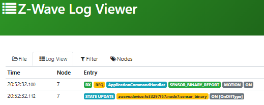

I can only address the binary sensor item from the log and it looks okay. Using the debug viewer I see;
Is the item linked to that channel a switch?
That’s the problem. The zwave log looks ok, but none of the configured items are updated (most of the time).
