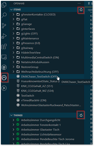

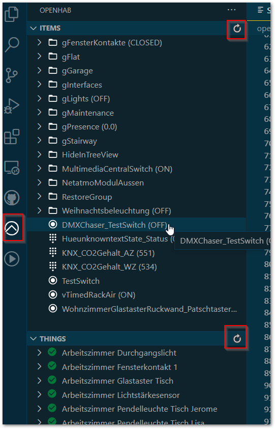

Is the "use rest API’ setting activated and can you reload the items and things browser?

What do you mean with: can you reload the items and things browser?

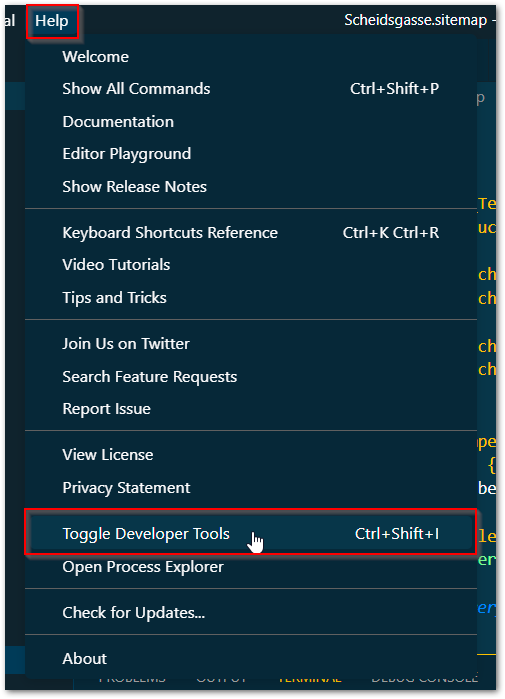

You may check if this works properly, to evaluate the api connection in basic.
Also you may check the developer tools, to check what hovering is doing currently and give us some logs.

Thank for all the screenshots.
First I do not have a icon on the left side to try the first question.
How will I get such icon?
The OpenHab Addon is installed.
