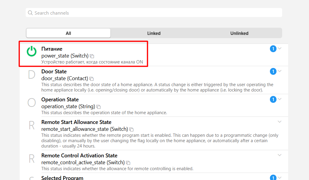

The dishwasher has the “power_state” channel:

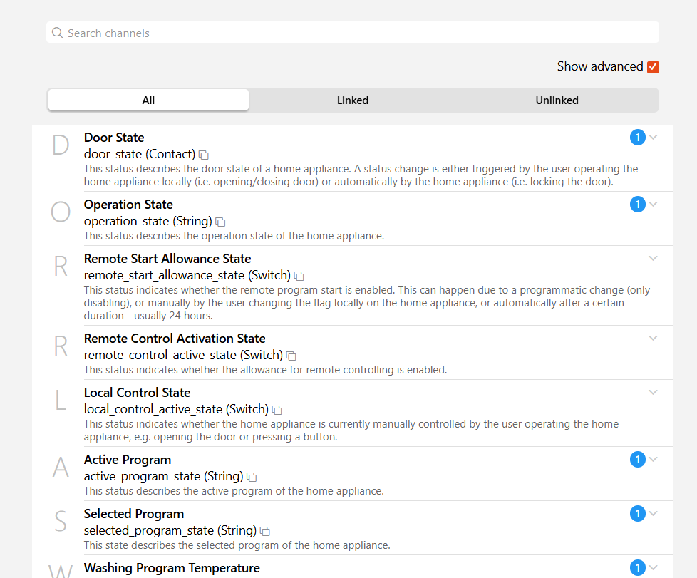

But the washing machine for some reason doesn’t (I have checked in advanced channels also):

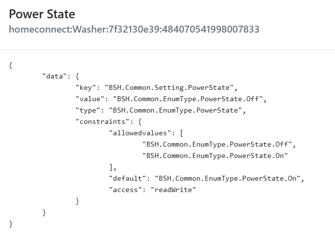

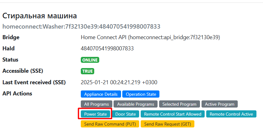

While it has this API Action available:
Could you please check why?
