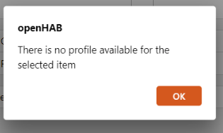

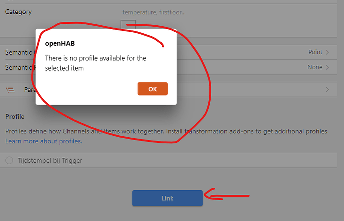

However, when I try to create an item for this thing in the OpenHAB3 web UI, I get this error
Why does such a simple thing fail ?
Here’s the steps I take

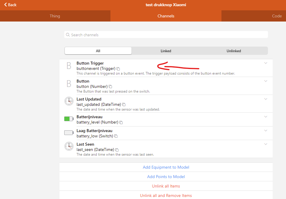

From the things list, I select the button
Next I select the Channel tab and select the Button Trigger channel
Next I click Add Link to Item ...
Next I select create a new Item
I don’t change any of the fields, when I click the Link button, I get this error message

That’s a Trigger Event Channel. You can’t link those to an Item. There is no state in this type of channel.
This type of channel can be used to trigger a rule directly. No items required or allowed.
rossko57
(Rossko57)
January 2, 2022, 8:56pm
3
Comment: technically, it is possible to link some event channels to Items, but it can only be done using certain profiles.
I don’t think MainUI properly deals with this circumstance.
But it is very rarely needed for any reason. It’s unlikely you need to do it here.
