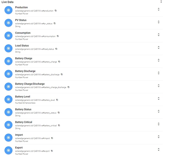

im setting up my solaredge roof solar plant, still having issues. Binding is installed but the only readings i get is the Production channel (Live, day, week, month, year) (although its inaccurate), NONE of the other channel work. Using REST API shows response “NULL” for all channels…
Any idea where to start?
My items file:
//*** Solaranlage -----------------------------------------------
//*** Live Status -----------------------------------------------
Number Production "Produktion [%.2s %unit%]" <solarplant> (gSolaranlage){channel="solaredge:generic:cb124819:live#production"}
String PV_Status "PV Status [%.2f %s %d %% W]" <solarplant> (gSolaranlage){channel="solaredge:generic:cb124819:live#pv_status"}
Number Consumption "Verbrauch [%s W]" <solarplant> (gSolaranlage){channel="solaredge:generic:cb124819:live#consumption"}
String Load_Status "Ladezustand [%% %sW]" <solarplant> (gSolaranlage){channel="solaredge:generic:cb124819:live#load_status"}
Number Battery_Charge "Batterieladung [%s W]" <solarplant> (gSolaranlage){channel="solaredge:generic:cb124819:live#battery_charge"}
Number Battery_Discharge "Batterieentladung [%s W]" <solarplant> (gSolaranlage){channel="solaredge:generic:cb124819:live#battery_discharge"}
Number Battery_Charge_Discharge "Batterie Ladung/Entladung [%s W]" <solarplant> (gSolaranlage){channel="solaredge:generic:cb124819:live#battery_charge_discharge"}
Number Battery_Level "Batterie Level [%s W]" <solarplant> (gSolaranlage){channel="solaredge:generic:cb124819:live#battery_level"}
String Battery_Status "Batteriestatus [%% %sW]" <solarplant> (gSolaranlage){channel="solaredge:generic:cb124819:live#battery_status"}
String Battery_Critical "Batterie kritisch [%% %s W]" <solarplant> (gSolaranlage){channel="solaredge:generic:cb124819:live#battery_critical"}
Number Import "Bezug [%s W]" <solarplant> (gSolaranlage){channel="solaredge:generic:cb124819:live#import"}
Number Export "Einspeisung [%s W]" <solarplant> (gSolaranlage){channel="solaredge:generic:cb124819:live#export"}
String Grid_Status "Netzstatus [%s W]" <solarplant> (gSolaranlage){channel="solaredge:generic:cb124819:live#grid_status"}
My binding page:
