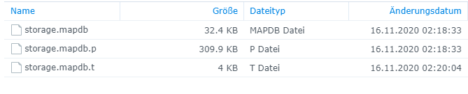

I check the following folder: openHAB/tmpfs/userdata/persistence/mapdb
The files are not so big.

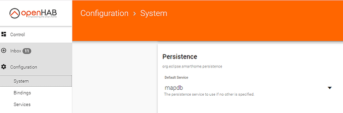

Screenshot from my PaperUI - Addons- Persistence:
It doesn’t matter how big the files are. What matters is how big openHAB/tmpfs is and how much other stuff is stored in it. Given that it’s a tmpfs that means it’s a RAM disk (i.e. it exists in RAM, not on a disk) so it’s likely pretty small itself. You probably need to expand the size of the tmpfs.
