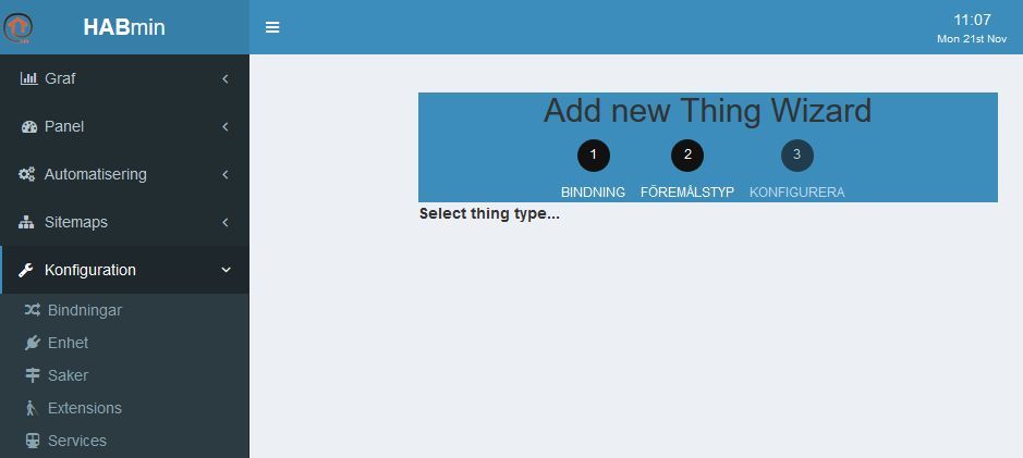

I’m new to openHAB and decided to try openHAB2 even though it is still in beta. I’m using the RaZberry addon card on a Raspberry Pi 2 and have, to my knowledge, successfully been able to…
  1. Install z-way to support RaZberry
  2. Install openHAB 2 w/ HABmin
  3. Install z-wave binding on openHAB
I have also, through, z-way been able to add a z-wave device to my raspberry but I have not been able to add any z-wave device or thing to openHAB…
When I try add a “Thing” I do not get any thing types to choose from in the wizard… Should I have z-way installed or is it sufficient with only openHAB? Shall the z-way-server be running?

The problem is, however, that when I follow the instructions that you liked to I am unable to add the Controller! When I choose Things Configuration and click the + sign I can not select any Serial Controller… :confused:
What am I missing here?
