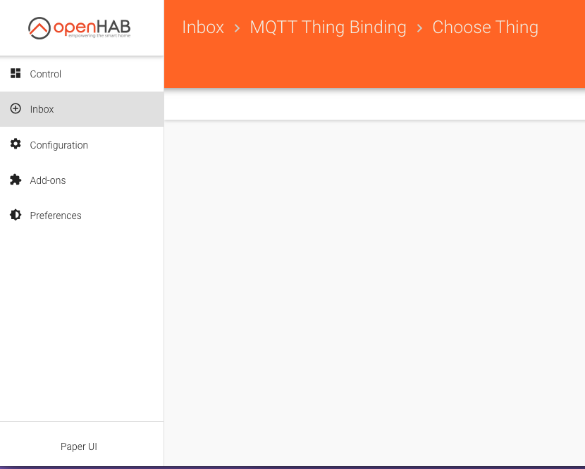

I’m unable to find any things listed when trying to add things to my MQTT Thing Binding.
Please see screenshot.

According to the MQTT Things and Channels Binding documents available here:
https://www.openhab.org/addons/bindings/mqtt.generic/
“Because every manufacturer can device on his own on which topic his devices publish, this binding can unfortunately not provide any auto-discovery means.”
The best tutorial on MQTT I found is available here:
MQTT requires a bit of configuration before it can do automatic discovery. And even then, it can only do automatic discovery on certain standards.
You need to click “Manually Create Thing” and choose MQTT from the list and create an MQTT Broker Thing. Fill out the information necessary to connect to your MQTT Broker in this Thing.
Then, since it doesn’t appear you are using anything using the Homie or Home Assistant MQTT standards, you will need to manually create a Generic MQTT Thing (same procedure as above). Once create you then need to manually create the Channels on the Thing where you enter the MQTT topics, transformations, etc.
You are using some script or utility to do that, maybe?

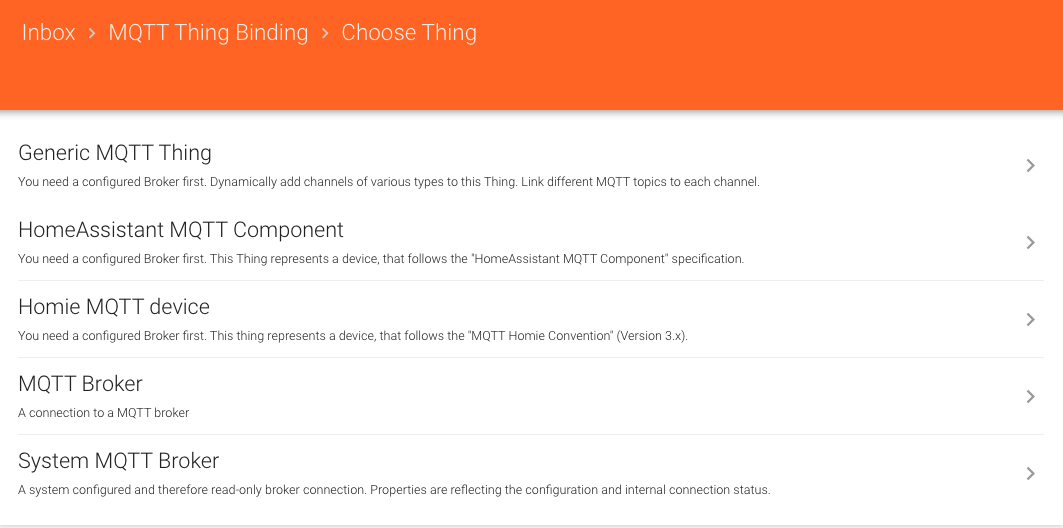

I did try clicking “Manually Create Thing”, but nothing appeared.
I was expecting at least the following:
-Generic MQTT Thing
-HomeAssistant MQTT Component
-Homie MQTT Device
-MQTT Broker
-System MQTT Broker
As I have seen on a number of helpful youtube tutorials…

None of which addresses your immediate problem I’m afraid, how to create a broker Thing.
PaperUI > Configurations > Things > + > Choose Binding
Have you actually installed a broker anywhere yet?
Do you have any errors in the logs? Which version of OH and the binding (if it’s a different version) are you running?

Somehow, it has appeared this morning, despite going through exactly the same steps as last night.
FYI: OH:v2.4 MQTT Binding: v2.4.0
