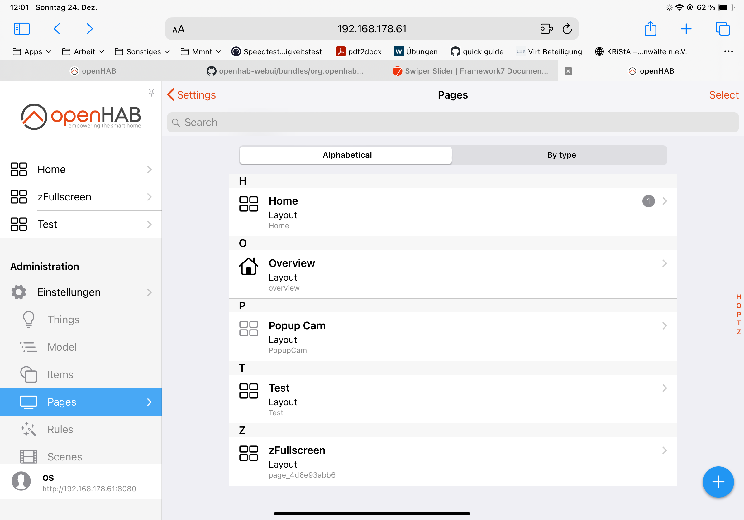

Hmm. This is really weird. I updated to iOS 17.2
It seems that the “first level” of MainUI does not get updated.
Example:
I changed a property of a page (adding to MainUI’s sidebar). Changes are visible on the details sheet (see screenshot)
but the order number is missing on this level and the page does not appear on the sidebar:
